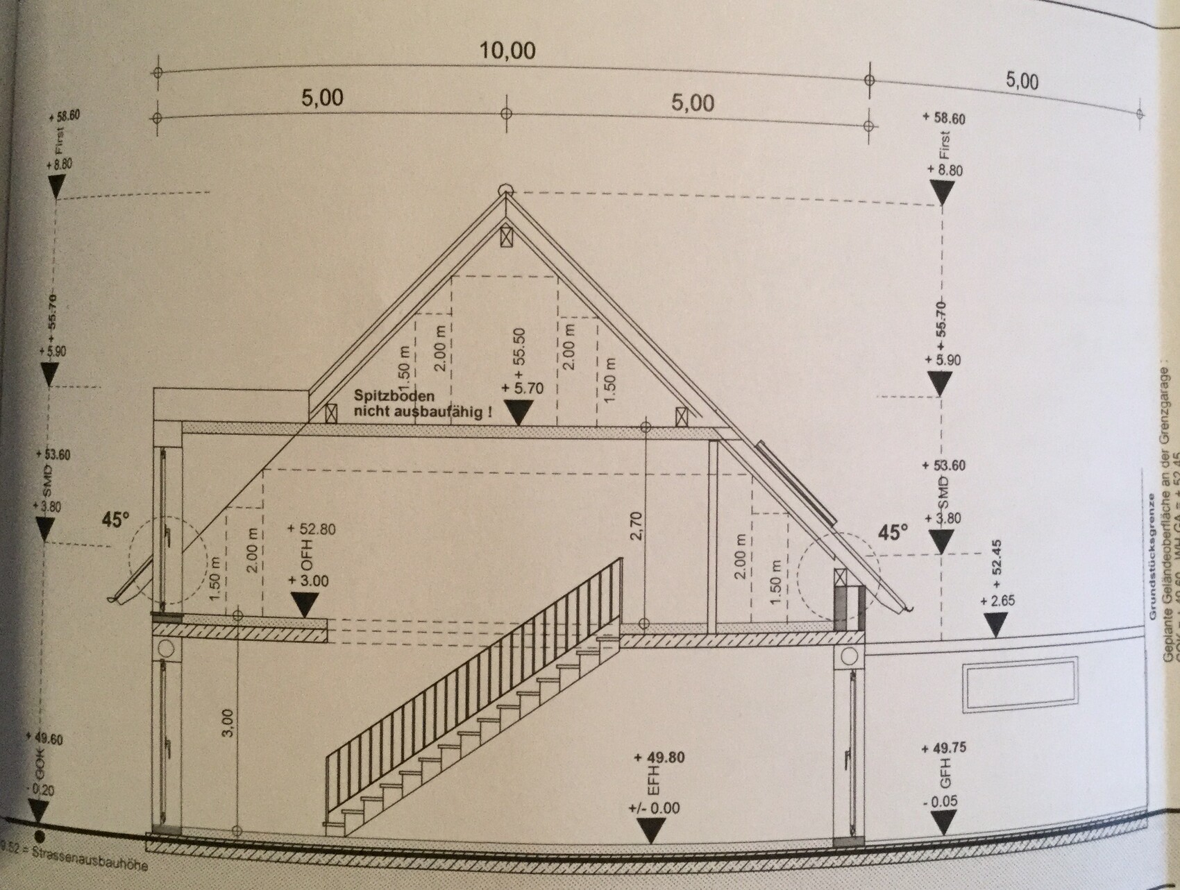

Our plans state "attic not suitable for conversion" – what does that mean exactly?
We actually wanted windows on both sides of the gable wall. However, he did not include them.
We planned to use a space-saving staircase for access. This was not shown in the drawings at all, as if the attic is not accessible at all...

Could the reason for “not suitable for conversion” be solely because of the space-saving staircase?

Knallkörper4 Jan 2017 14:49Dirk Grafe schrieb:
Direct hit. Although the architect should have informed you about this, since you expected to be able to use the space. Perhaps it can be declared as storage and then you might still be able to add a staircase and windows into the roof.
Dirk GrafeWhy does finishing the attic affect the number of full stories of the top floor? I don’t quite understand the connection.
