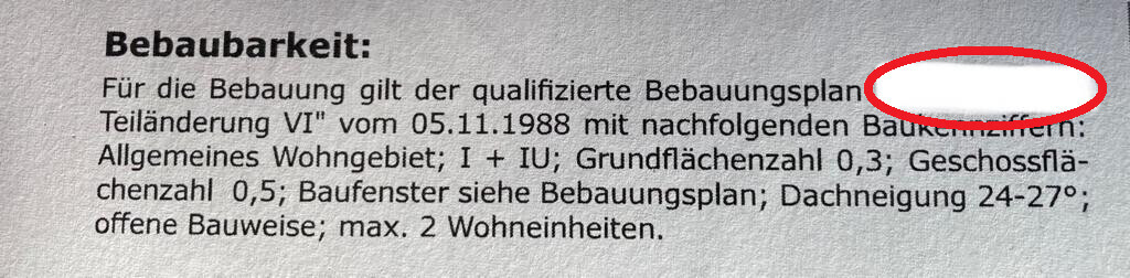

According to the development plan, a house with 1.5 floors, a gable roof with a pitch of 24-27 degrees, and no knee wall is permitted. We are wondering how this is supposed to work. Does anyone have experience with this and a solution to offer? We actually want to build a prefabricated house, not an architect-designed house (due to cost certainty).

I only managed to read up to about the third line. Apparently, it is a sloped site where you are allowed to build a single-story plus a basement. In addition, one side of the roof can have a pitch of over 60° (degrees). … It’s all good 🙂
Please share the section of the development plan related to the property as well as the textual supplements.
The text mentions a slope. Are there any elevation details in the plan?
A 6 m (20 ft) eave height doesn't sound too bad. It suggests about two stories plus a roof. The development plan seems quite old. What does the local authority say about deviations?

So far, we don’t see any reason against choosing a prefabricated house or a modular solid construction house, except perhaps for some design aspects. We have concerns that due to the zoning plan (building permit / planning permission) and ground conditions, a prefabricated house might not be feasible or would require many modifications, which would increase the costs.
Unfortunately, we are complete beginners and cannot properly interpret the zoning plan.
That’s why we are asking the forum.

So far, we don’t see any reasons against a prefabricated house / solid prefabricated house. Except maybe some design choices. We have concerns that due to the development plan and soil conditions, a prefabricated house might not be possible or only with many modifications, which would increase the costs.Basically, you need to distinguish between the planning and the construction method. Catalog houses (standard model homes) are available both as solid construction and timber panel construction. Similarly, you can build a custom house either in solid construction or timber panels. Both options are essentially equivalent in this regard. Elements in contact with the ground are usually made of concrete anyway.An expensive option is to take a catalog house and then modify it with 15 changes. In that case, a custom-designed house is cheaper, but many prefab builders also offer this option. Adjustments due to unfavorable plot profiles or soil conditions tend to be costly for both methods.
