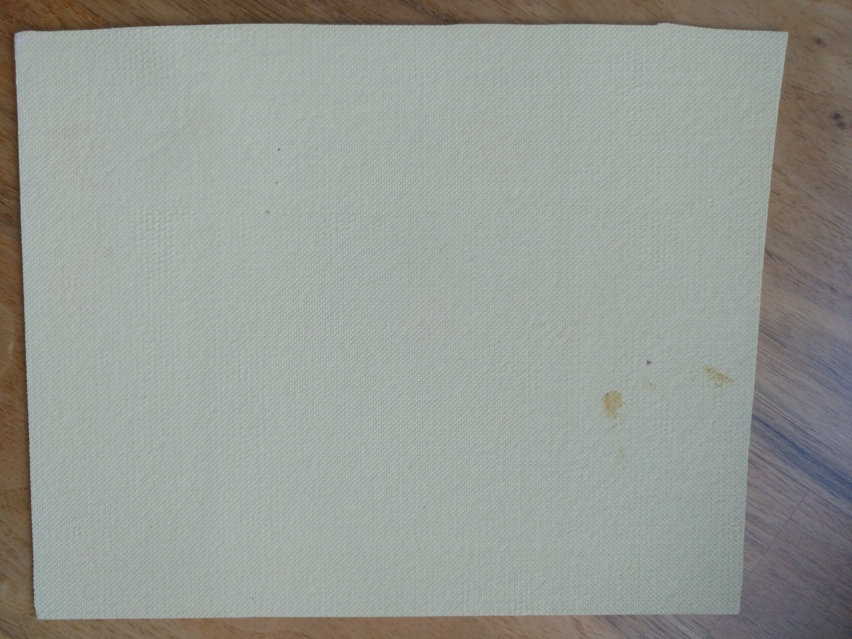

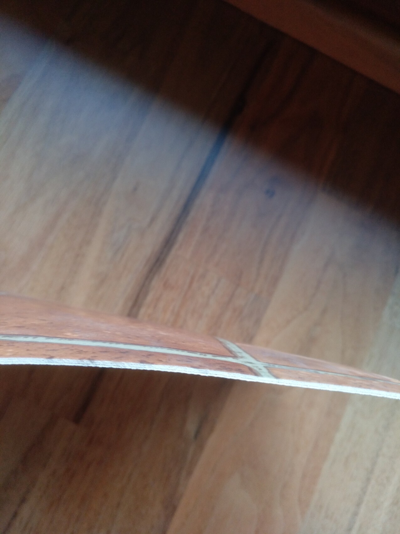

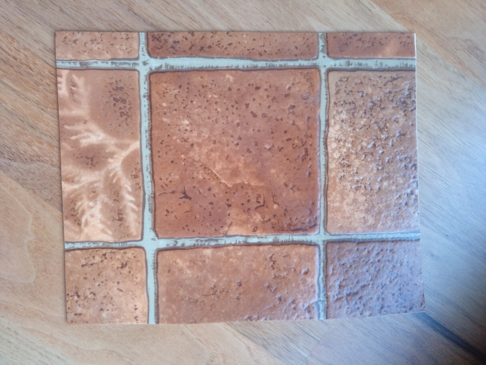

I would like to find out if I released asbestos back then or if asbestos is still coming up from under the new floor into the indoor air.
I still have one piece of carpet remnant with adhesive. However, several different carpets had been installed.
From my research online, I learned that dust sampling (stamping) or material testing can be done. However, I would prefer not to remove the newly installed flooring again. My main concern is whether there is an immediate health risk in the current situation. Therefore, I would appreciate your opinion on how you would proceed to clarify the situation.

Dangerous remote diagnosis: Vinyl is safe, that’s PVC or some other type of foam plastic.
I also want to emphasize again that by the early 1980s, asbestos was hardly used in flooring materials anymore.
If you want to be absolutely sure, just send a sample to a lab—analysis costs around €70 (about $75).
