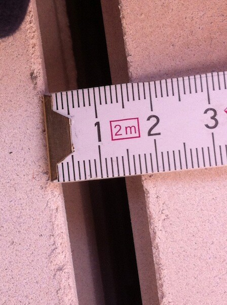

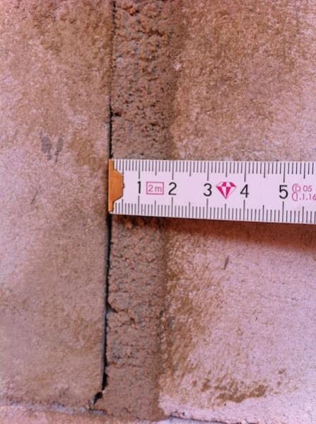

Today, I noticed larger gaps in the partition wall (calcium silicate brick) of our new build (semi-detached house).
Is this "normal," or should I raise this issue with the builder?
Thank you and best regards

I am referring to the wall itself, not the joint between the two semi-detached houses.

do you mean because mortar is missing in the joint? Or is it because the joints are too wide for your taste?

In terms of sound insulation, I find the joints too wide.
