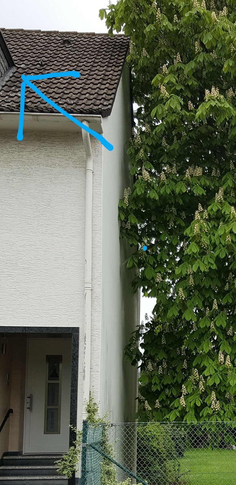

Schneider13
7 May 2019 21:25
Fairplay-Haus schrieb:
So you mean the small white house, right?
It clearly looks like a two-story masonry building with an attic. The roof is quite flat as well. Are there dormer windows?
I think so. Unfortunately, I don’t have another picture. I’ll have to check it out tomorrow.

F
Fairplay-Haus
7 May 2019 21:27
Well then, they definitely didn’t build without a proper building permit / planning permission.
Schneider13
7 May 2019 21:30
Well then, he definitely didn’t build "illegally."
Just to make sure I understand correctly. I could basically build like the White House and add two large dormers if I’m allowed to build them. And then the house would be considered three stories?
F
Fairplay-Haus
7 May 2019 21:37
Not exactly, it’s not that simple. By calculation, a full third floor must be created. Two-thirds of the roof area must have a height of 2.30 m (7.5 ft). Since dormers are usually as high as the attic floor, they are included in this calculation. So: a roof pitch of 25°, a knee wall of 60 cm (2 ft), and two dormers on each roof side, adjusted to the required size, should be sufficient. This must be approved through a building permit / planning permission exemption. If the building authority agrees to the exemption, it will work. You should consult a planner or architect for advice.
Schneider13
7 May 2019 21:41
Not exactly, it’s not that simple. In terms of calculation, a third full storey must be created. Two-thirds of the roof area must reach a height of 2.30 m (7.5 ft). Since dormers are usually as high as the attic, they are included in the calculations. So: roof pitch 25°, knee wall height 60 cm (24 inches), and on each roof side, two dormers sized accordingly should be sufficient. This whole setup must be approved with a building permit exemption request. If the building authority agrees to the exemption, then it will work. You should consult a planner or architect for advice. Basically, just for a consultation.
Thank you very much for that.
I’ll look around for someone who can do this affordably, since consultations aren’t free anymore these days.
But at least now I know a lot more. Best regards
