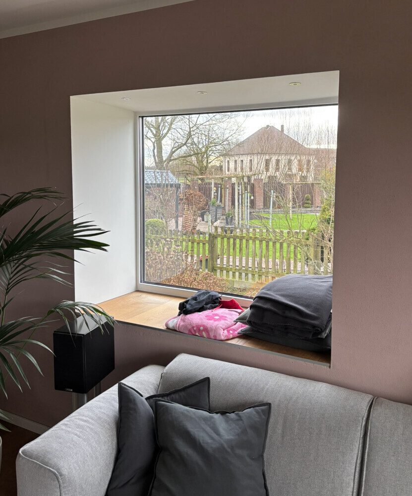

nordanney29 Jan 2025 10:23Murmele305 schrieb:
We are unsure whether the window seat on the ground floor is practical and will actually be used. Since it’s not used, the couch is now placed in front of it.
wiltshire29 Jan 2025 10:33nordanney schrieb:
Since it’s not being used, the sofa is now placed in front of it...
And it looks good.In a corner window seat bay, comfortable seating is possible for only a few adults but for most children it works well. If you imagine sitting there to gaze out thoughtfully or read a book, it’s rarely practical.
When more people are in the living room at Christmas, a window seat like this can be a great spot where children can sit and/or play. Also, when guests are around and you want to sit not awkwardly cornered but more conversationally in a circle, a window seat is a great feature that saves space. Everyone fits in without requiring more square meters (square feet). (However, looking at your design, you do have some unused space between the marked sofas and dining table.)
We don’t have a window seat, but an oven bench. It’s not used often, but when it is, it’s very much appreciated. That makes it worthwhile.
hanghaus202329 Jan 2025 10:48I like the one from @nordanney, even though hardly anyone sits there. The "typical" window seats, commonly seen on Pinterest and similar, usually have a protruding wooden cladding inside the entire reveal, which is 1. expensive and 2. takes up space when it sticks out; but as shown in the photo, it looks neat and it doesn’t bother that the sofa partially stands in front of it. This, in turn, would suggest a higher window sill than what we have; which is also why TE really should urgently draw in correctly dimensioned, real furniture.
From what it looks like in your case, you have a wall thickness of at least 40cm (16 inches) and the window is flush with the outside. In the previous thread on this topic and also here in the plan, the window is planned centered in the exterior wall, and then this monster protrudes into the room like a cupboard.
@Murmele305 This image shows you the key details, including the sill height and depth; the additional cost is only due to the somewhat larger windowsill.
