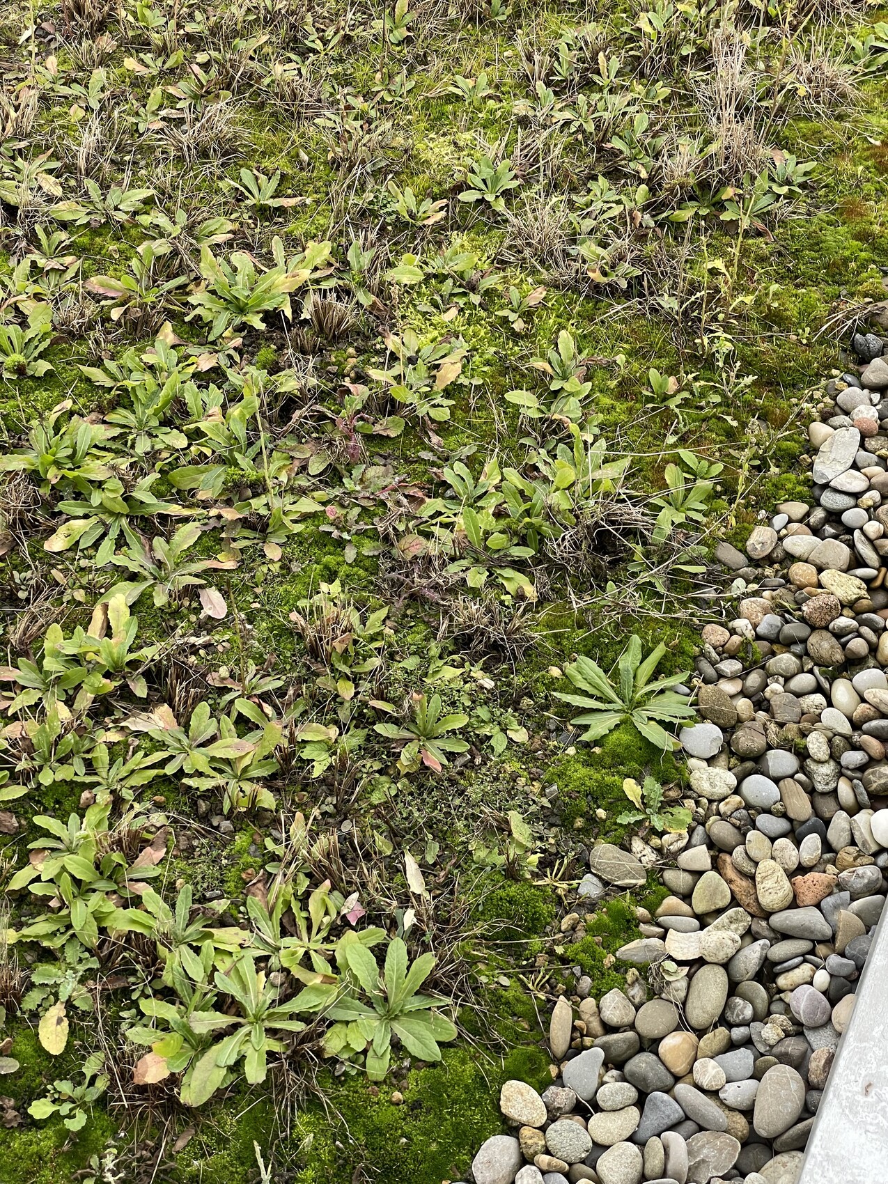

Unfortunately, our construction company hasn’t managed to install a green roof on our garage in two years. The seeds were always sown during very hot weather, so nothing grew.
Now, over autumn and winter, a lot of moss (I assume that’s what it is) and weeds have appeared. See the pictures.
We would now like to do the greening ourselves.
Should the moss be completely removed beforehand, or can it be left as is?
Regarding Bauder, I noted: Should we just sow seeds or also plant sedum plants?
Oh, and we live in a rural area surrounded by fields, in case that matters.
Thanks in advance!
Thanks in advance!
WilderSueden31 Mar 2023 11:42I would remove the moss and also avoid using pure sedum. There are beautiful mixtures for green roofs with a variety of different plants. These usually require exposed soil during sowing. It can also be worthwhile to work with a mix of established plants and seeds.
