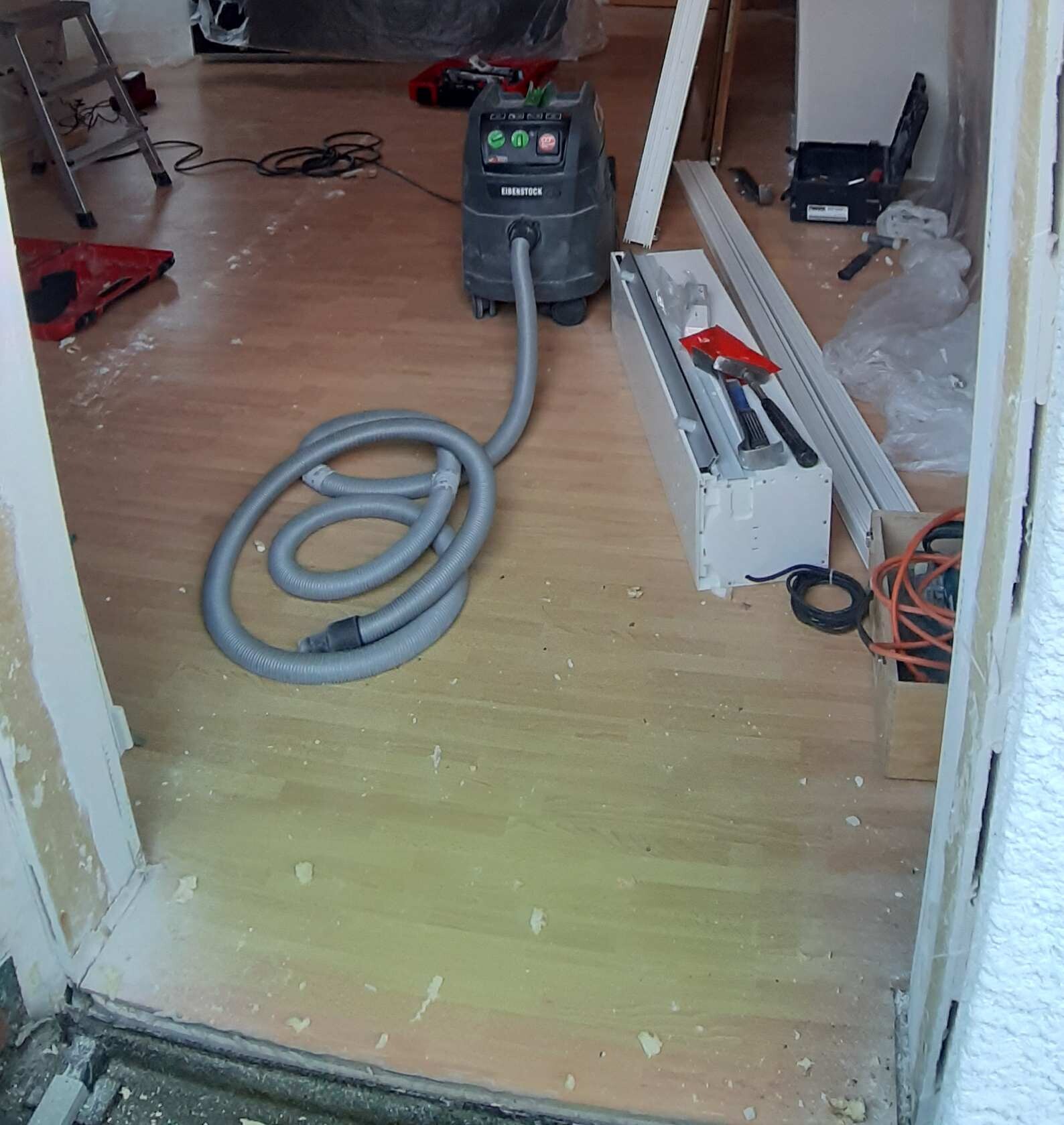

We realized how strong the sun can be during the renovation. Over the years, the laminate floor had turned green (!):
