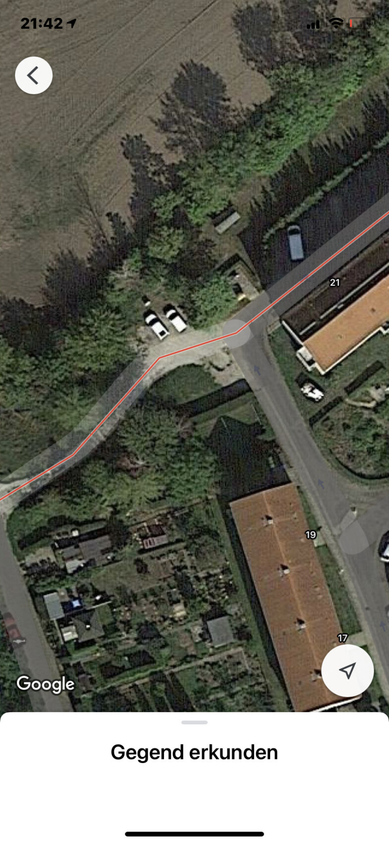

The plot is on a slope. The house would be situated above the slope, and the area where it would be built is flat. However, what concerns me is that on the right side, where the plot ends, it drops very steeply in a near-vertical line. I would estimate the height difference to be about 3 meters (10 feet). Next to this side, there are no buildings, just fields. This side would definitely need to be stabilized. Unfortunately, we have no experience with this and are wondering what additional costs we should expect.
We are also wondering if the overall sloping location could be problematic in terms of requiring further ground support or reinforcement.
Although we have really fallen in love with the plot, we definitely want to avoid any unpleasant surprises.
I have attached a photo showing the general location. Unfortunately, I did not photograph the slope on the right.
We would be very grateful for any tips and advice.

The general slope of the plot is quite visible in the last picture. It gently slopes downward but is flat in the upper part. From my amateur perspective, this doesn’t seem to be a major issue. However, on the right side towards the field, it slopes down quite steeply.
I attached a Google Maps image, but you can’t really see that clearly there. In the other picture, you can just see behind the tree how steeply it drops.

You can see it clearly on the tree.
Otherwise, I would have thought that this is not really a slope, but rather a terraced plot. It looks like it might have been created by the excavation work from the multi-family house and construction debris.

Be sure to have a geotechnical survey done before purchasing!

hampshire22 Apr 2021 23:29The slope is also visible at the fence. Photos tend to flatten things out. On a slope, financial challenges arise. Technically, everything is feasible. The 3m (10 feet) doesn't initially sound particularly expensive.
You have to be willing to build on a slope. You say you like the property. That’s what matters. Often, sloped plots are somewhat cheaper, which partly offsets the additional construction costs.
