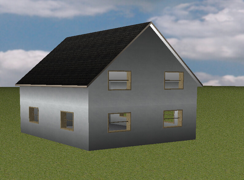

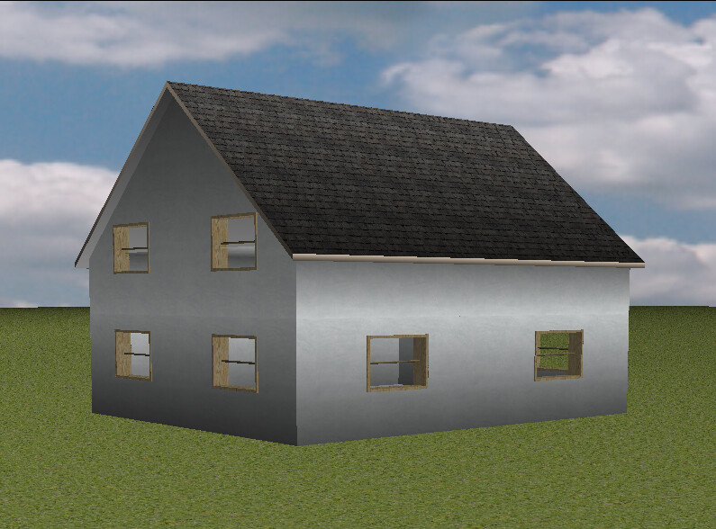

If it’s just a matter of imagination, we can help. Here is a sketch with 1 full floor, knee wall height 1.40m (4.6 ft), and a 40° roof pitch:

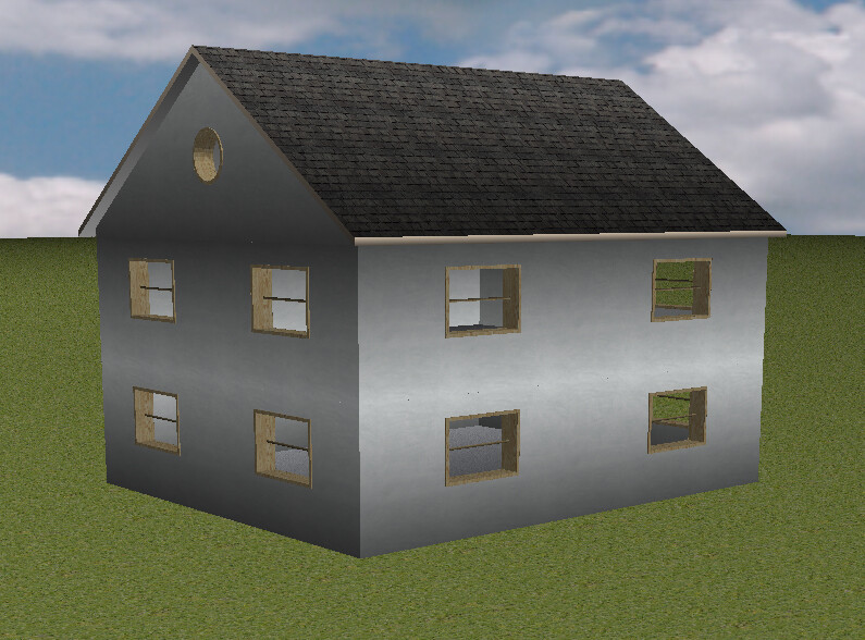

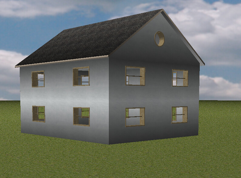

And here are 2 full floors with a 35° roof pitch:
Personally, I find the 2 full floors more attractive, but it will likely cost significantly more – of course.

The first visualization from the architect looks noticeably steeper than the one from kaho674...
