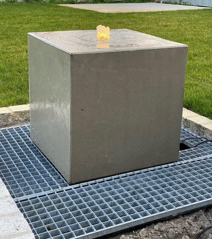

Next to the raised bed, there is now a water feature. It’s not finished yet, though. The netting and the stones around it are still missing.
Also, the sun moves toward the left, which means the left side is west. The sunlight then comes in from the side. From the afternoon/evening onward, we wouldn’t be able to sit in the shade anymore.
