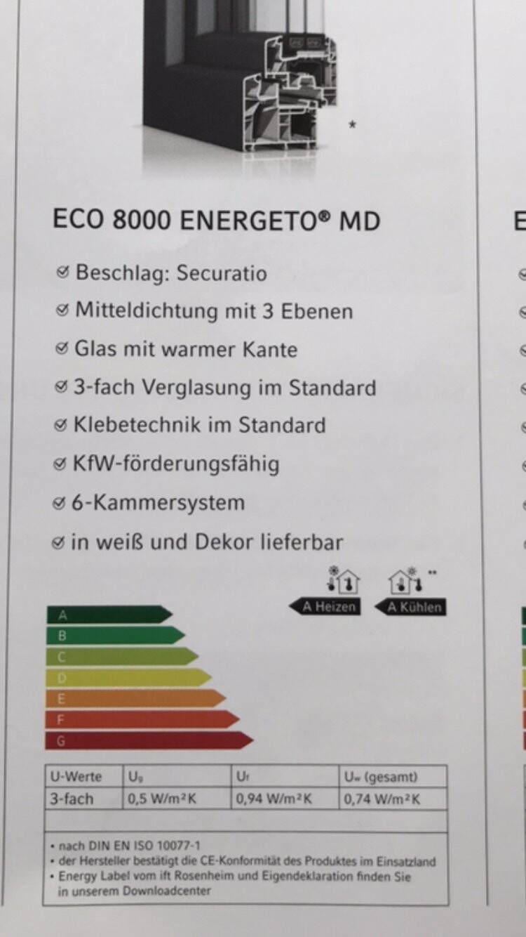

I was recently offered Brand windows.
The color is baked on with heat or something similar. It’s not just a simple foil.
They have a construction depth of 85 mm (3.3 inches) with these specifications.
Does anyone have experience with them? They are supposed to be good, but I haven’t really looked closely at the technical values.
These are probably a number of better-quality windows than the standard ones usually offered. I’m not sure if the price is fair, but given the number of windows, it seems reasonable.
