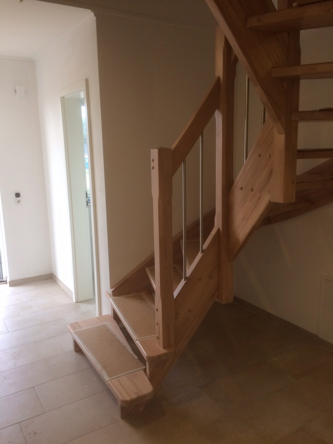

1 - Attic:
This is a cold roof, meaning the floor between the upper floor and attic is insulated with mineral wool and has a vapor barrier in between.
The goal is to create more storage space. The attic is not intended to be used as living space.
For this purpose, I want to use tongue-and-groove boards, as these are vapor permeable compared to OSB panels and therefore prevent issues with rising moisture from the upper floor.
Questions:
The attached picture is provided as an example.

1 - Attic:
Questions:
- So far, a pull-down attic ladder is planned. My wife prefers a fixed space-saving staircase with a railing for easier access. In my view, this should be no problem as long as the access hatch to the attic remains insulated. Are there suitable solutions for this?
- We would also like to dry wet laundry in the attic. In our case, is this unproblematic? I believe the evaporated moisture could easily escape.
- What do you think, how much effectively usable floor area would this create?
- Do you have any personal experience with this?

EnnoBecker schrieb:
Without being too forward: Would you be willing to share 1-2 pictures of your attic? I’d like to get an impression of the actual space available.Maybe this helps a bit. The house dimensions are roughly the same as yours, but the roof pitch is lower. We have about 1.75 m (5 ft 9 in) of standing height in the middle. Otherwise, you can see roughly half of the floor area here. At the back in the shadow, there’s an additional length of OSB boards, about 2.25 m (7 ft 5 in), which you can’t see.
From experience with a similar attic space.
Install a Velux window or similar skylight to ensure proper ventilation. Our attic stays really dry, although it can get quite cold. Paint peels off in winter due to freezing. Garden cushions, boat cushions, blankets, and so on are stored there without any damage. However, you should not dry laundry there because modern breathable roofing membranes don’t allow enough airflow. The ventilation is insufficient. We tried a couple of times, and moisture showed on the cushions. We bought a dryer and stopped drying laundry up there — problem solved, everything stayed dry.
A staircase is essential, along with a small hallway upstairs, then a patio door or terrace door as an entrance; otherwise, things warp. The insulation around the patio door is adequate.
Garages are less dry than the floor space, but oddly less cold. The paint in the garage does not freeze. I store tools, bikes, extension cords, polish, WD-40, garden tools, a lawn mower, and an old refrigerator for garden parties there. All of that works fine.
Consider why you really need a car in the garage. It is painted and galvanized and can withstand outdoor exposure well. You save money by turning a standard 6 by 3-meter (20 by 10-foot) garage into a great garden shed, storage room, or workshop area, leaving the car outside. Attached are pictures for illustration. Karsten
