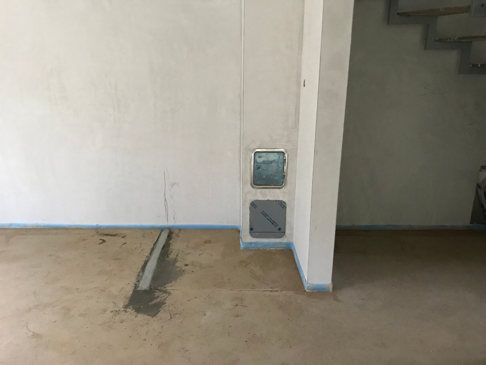

In our new build, the screed recess for our fireplace kit (about 600kg (1320 lbs)) was initially made too small. After complaining, it was enlarged as shown in the pictures. To me, as a layperson, it looks quite "improvised," but I might be wrong, so I would like to hear your opinion on this.
What stands out is that the expansion of the recess was clearly done with a different screed material, possibly cement screed, instead of calcium sulfate screed.
Is this a "normal" and "safe" procedure? Can we confidently place our fireplace on the enlarged recess without risk of the extension failing? What should we pay attention to, and should we complain again?
Thank you very much for your assessment.
Seol

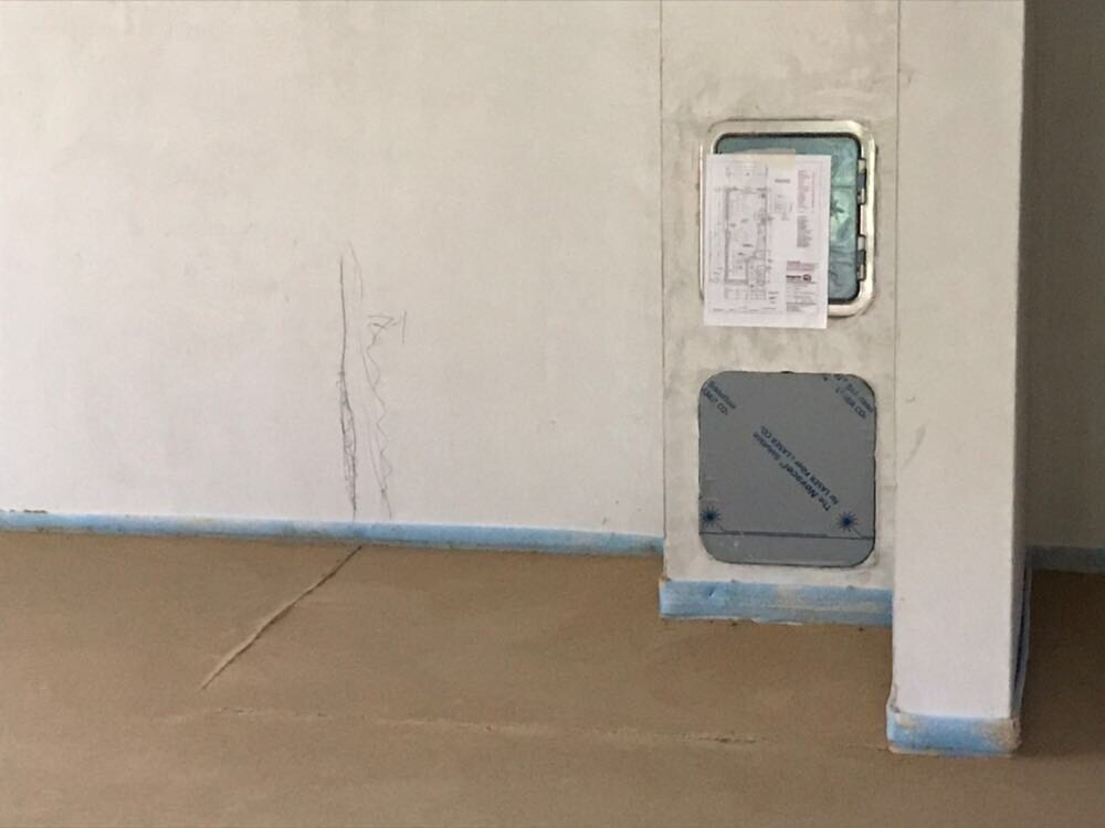

In our new build, KfW-40 standard, without a basement, the underfloor heating was installed on the insulation, which lies on the slab, and then covered with calcium sulfate screed. Since underfloor heating is not allowed in the area of the fireplace, none was installed there. According to the screed installer, the standard thickness (6 cm (2.4 inches)) of the calcium sulfate screed is not sufficient to support the weight of the fireplace (approximately 600 kg (1,322 lbs)), so a thicker screed layer (around 8.5 cm (3.3 inches)) was applied in the fireplace area. I refer to this area as a "recess" because there is a clear visual separation. The situation was as follows:
Unfinished interior construction site: white walls, blue floor covering, installation opening in wall.
Unfortunately, this "recess" was not large enough as agreed beforehand to fully accommodate the base of the fireplace. The width was about 3 cm (1.2 inches) too narrow, so part of the fireplace would have rested on the thinner screed. This had to be corrected.
What seems to have happened, in my view, is that a strip about 5 cm (2 inches) wide next to the "recess" was cut out and then recast with what is hopefully a stronger (also around 8.5 cm (3.3 inches)) screed. Notably, it appears to be a different material. The result is as follows:
Unfinished interior with raw concrete floor, unpainted walls, and wall openings.
Is this clearer? Since I am a complete layperson, I have the following questions:
  • Does this approach make sense and is it understandable to you? What is your assessment of this?
  • Is using a different material as an "extension" of the "recess" acceptable, or do you see obvious disadvantages or defects resulting from this?
Thank you very much for your feedback.

KlaRa10 Jan 2018 18:21
Hello Seol,
It is correct that a 600kg chimney placed on a load distribution layer (screed) equipped with impact sound or thermal insulation will cause problems. Screeds in residential construction are designed to carry loads up to about 200kg/m² (41 lb/ft²). In room corners, as shown in your pictures, much higher bending moments occur under load than in the flat areas. Therefore, the screed installer’s advice was absolutely right!
Heavy loads, whether in residential or industrial construction, should ideally be transferred directly to the concrete slab or floor structure. In your case, I would have built a base at the necessary height bonded to the raw ceiling, where the chimney could then be placed.
Between the bonded and floating construction, a movement joint about 5–10mm (0.2–0.4 inches) wide runs through the entire cross section to ensure the system functions crack-free over time.
The materials and their colors used in the layers are not really important. I assume from the ochre coloring that a calcium sulfate screed was used. The gray stripes in current photos indicate a cement screed.
This is not ideal because the two binders do not interact well, especially if moisture is present. However, if the overall system remains dry (which seems likely), there will be no issues later.
The joint chamber will be well cleaned of fine sediment by vacuuming later, then after installing the top flooring, a round cord about 5–7mm (0.2–0.3 inches) deep will be inserted into it. The joint is then elastically sealed on the top with a color-matched flexible sealant aligned with the floor covering. The round cord serves as a depth limiter for the sealant.
To sum it up: I would not worry much about the color differences now.
It is of course unfortunate that the opening for the chimney was initially made too small, but in construction, there are certainly worse problems!
Subjective remarks such as “botched work” do not help and only reveal a lack of technical expertise!
Good luck with the further finishing work: KlaRa
