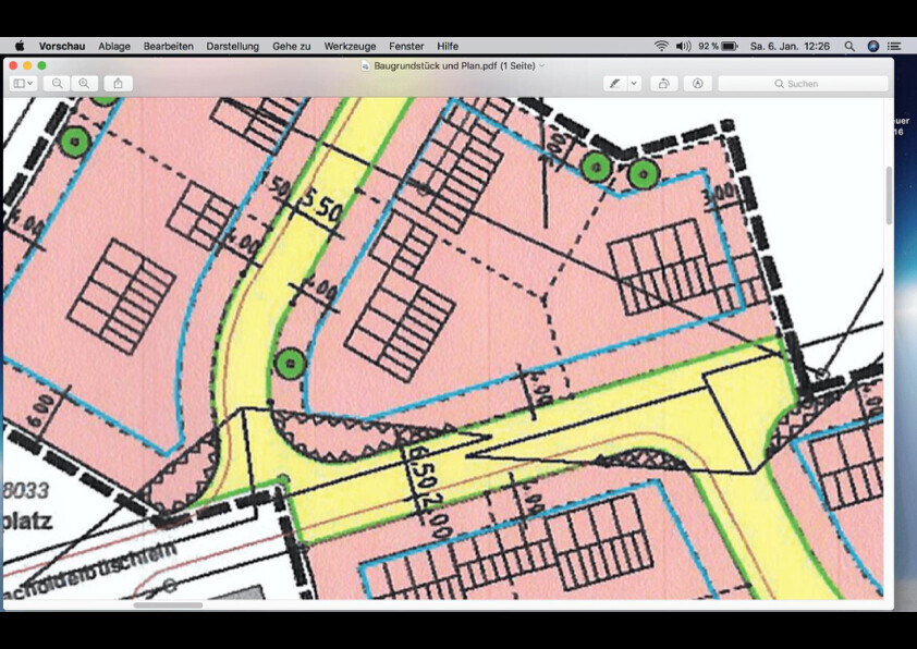

I have attached a screenshot of the mentioned plot in the attachment. It also shows the visibility triangles, which I find reasonable. After all, I will be using the street and want to avoid any danger when crossing it. The blue line indicates the building area (4m (13 feet) from the boundary).
My idea is to build the fence 0.80 m (0.9 feet) high according to the development plan and plant a hedge 3 m (10 feet) behind it at the desired spots as a privacy screen. This way, the visibility triangle is maintained without endangering anyone, while we still achieve the privacy we want.
My main concern is whether this complies with the regulations and that we are not doing anything wrong. We will lose some square meters of usable space, but privacy is more important to us.
PS: The pre-marked houses and garages are just placeholders. We plan to build the house and garage as far “up” on the lot as possible so the garden can be as large as possible.
Of course, I will contact the city again to verify this with the official source. Unfortunately, it is more difficult to do so on a Saturday.
@Alex85 This is not a heavily trafficked street; moreover, it is a new development area. However, it is possible that additional plots to the north will be developed later, which could increase through traffic.
@ruppsn The visibility triangle is shown in the screenshot. Within the visibility triangle, we are only allowed to build up to 0.80 m (0.9 feet) high, and at boundaries bordering streets, up to 1 m (1.1 feet) high.

The building boundaries are adapted to the visibility triangles, so I don’t see much of an issue as long as they are kept clear. Keep in mind, you could theoretically place your building exactly at that spot, and with a 4m (13 feet) distance from the property line, it could be up to 8m (26 feet) high (applying the 0.5h rule for the building section). So, the 2m (6.5 feet) won’t be a problem.
But feel free to check with the city again. It might even help to include the planting in your site plan submission; it won’t hurt and then you’ll have certainty and be able to sleep better [emoji4]

@ruppsn I hadn’t considered it that way before. But you’re absolutely right, I could build the house right on the boundary line, and it would be considerably larger than 2 m (6.5 ft).
I’ll call on Monday, but now I feel much more confident.
