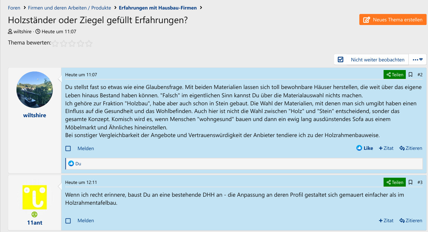

I had already answered your question earlier before it was apparently moved from the incorrect category "Experiences with house building companies": https://www.hausbau-forum.de/threads/holzstaender-oder-ziegel-gefuellt-erfahrungen.49178/#post-689446
