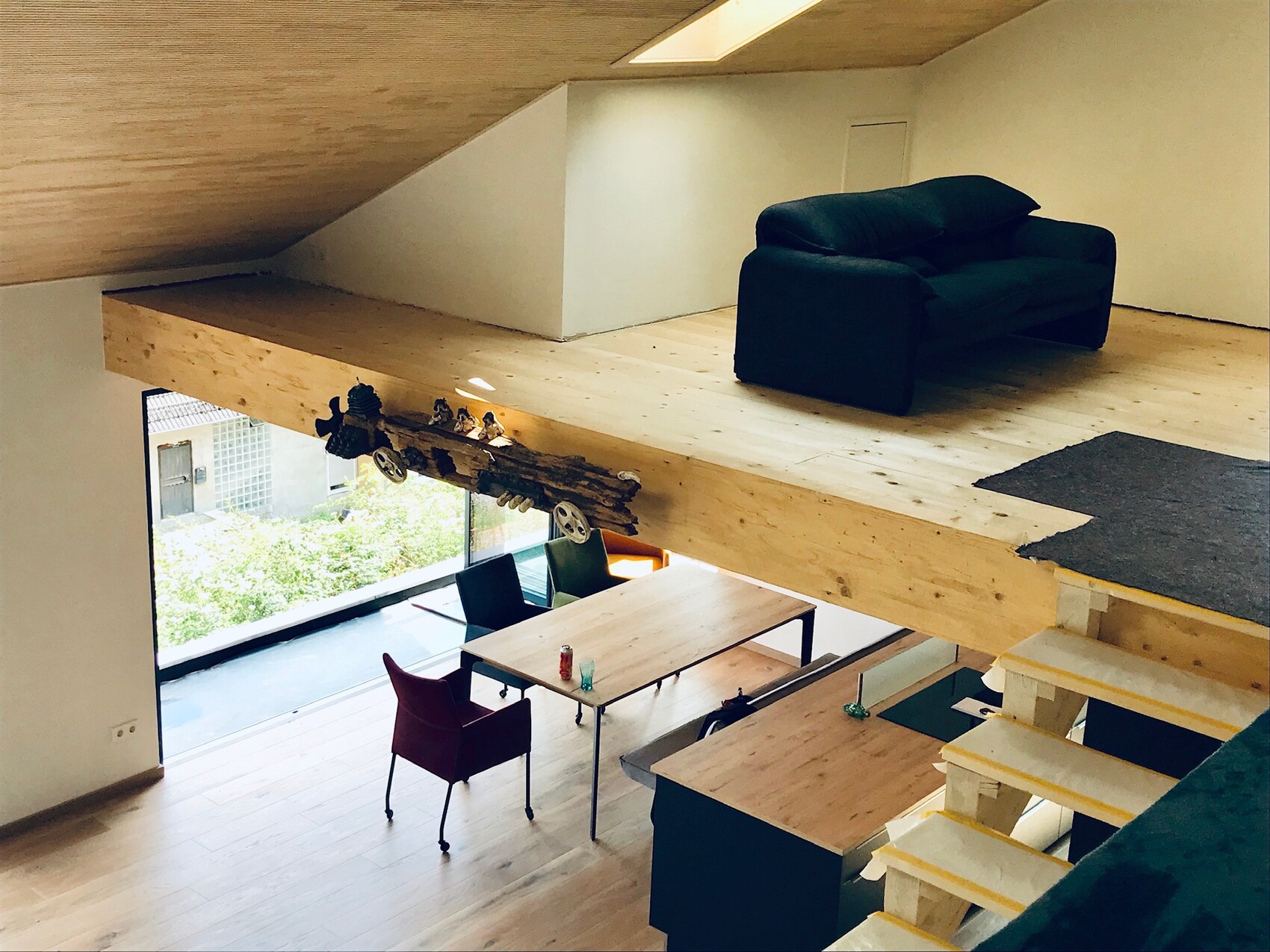

hampshire3 Nov 2019 23:47Here is a photo taken through the "open space" looking down at the dining table. In the meantime, there is also a railing installed on the gallery and the terrace.
Open spaces and galleries like these vary visually as much as the houses themselves. A photo like this hardly helps much.
Advantage: air volume and a spacious feel — this was definitely what we wanted to achieve.
Potential disadvantage: echoing room acoustics — solved here with an acoustic ceiling from LignoTrend.
Disadvantage: it gets louder upstairs when there is activity downstairs — not an issue for us.
The space upstairs only becomes tight if this kind of solution is applied in a house that is too small. In a new build, you can influence this.
