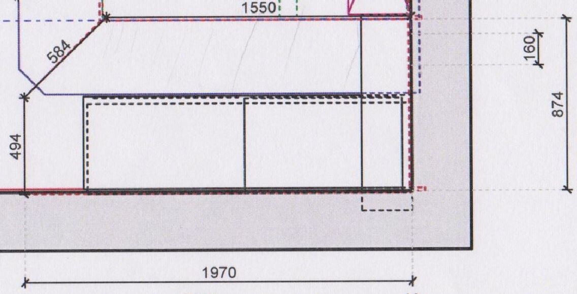

As part of our renovation, the kitchen will be completely rebuilt.
On one side, a small seating area is planned, where you will sit on the "back side" of the countertop and essentially use it as a kitchen table.
A typical countertop height (in our case 93cm (37 inches) above the finished floor) is naturally a bit higher than a standard table height. This height difference will be evened out by a platform beneath the seating area.
The outer dimensions of the platform will be 1970 * 494 * 584 * 1550 * 874 mm (77.6 * 19.4 * 23 * 61 * 34.4 inches).
The height is planned to be 195 mm (7.7 inches).
The platform was planned by the kitchen studio during the kitchen design, but we will build it ourselves and then have it tiled by the tiler with the same tiles as the rest of the kitchen floor.
My idea was to build the platform using a wooden beam construction to provide adequate stability and then cover it with MDF panels, onto which the tiles would be applied.
Now, I am somewhat concerned that this construction might not be stable enough (I think there could be a risk of tiles cracking or similar with movement) or that it might develop noises over time when someone steps on it (such as creaking).
I would be very grateful if you could share any advice or even experiences regarding what would be advisable or how you have solved similar constructions!
Thank you very much in advance for your help and have a great weekend!

I originally included the dimensions just to give an idea of the size of the platform; I’m not planning to change the design... 😉
The platform is, of course, located in a corner of the room (see the attached picture), completely underneath the countertop. Below the seating area, there are two drawers integrated for additional storage.

Porous concrete came to my mind as a building material. I had to look it up first 😉 (where I live, we call them Ytong blocks...) It’s a very good idea!
But then you can’t have a drawer. The drawer will be installed in the base structure of the seating area, which itself stands on the platform. Sorry if I wasn’t clear about that!
And I already knew that the platform would probably be in a corner. Still, it wouldn’t be my choice. Of course, it’s a matter of personal taste (I immediately liked the kitchen planner’s idea!), but it definitely isn’t a tripping hazard in that position!
