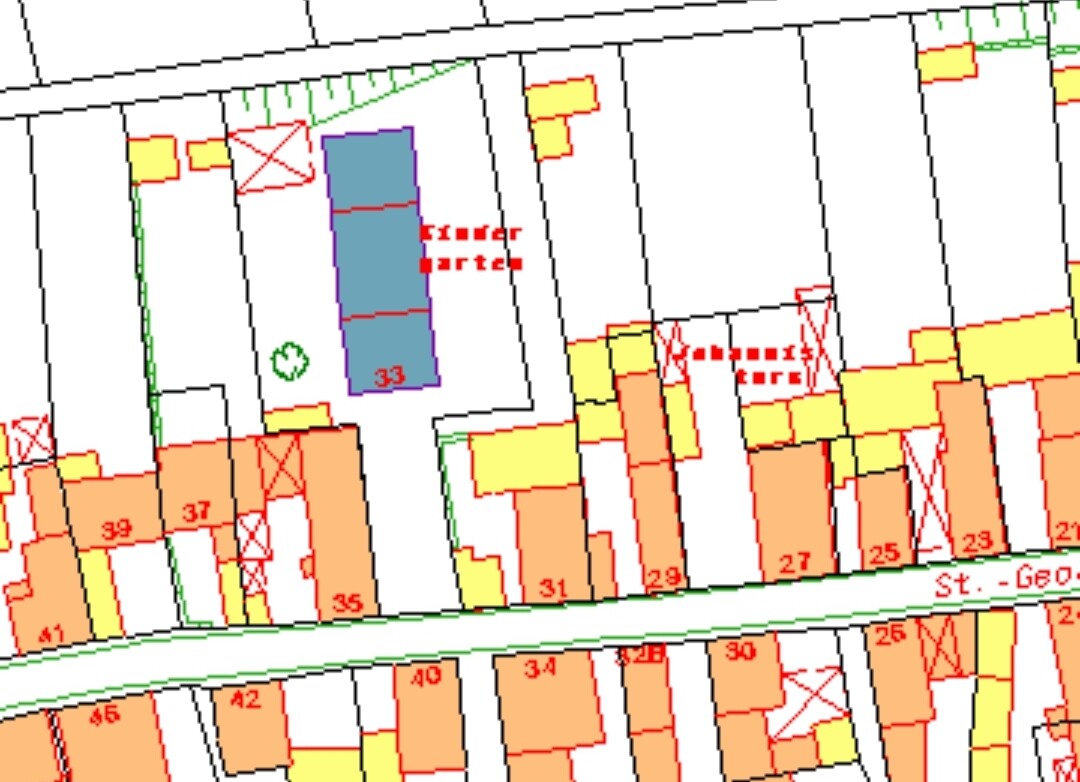

Could it be that you just started googling narrow floor plans without proper knowledge, assuming everything is possible? Please see the geoportal excerpt attached. There is no zoning plan available there. All the plots are this narrow. However, these are not terraced houses.
I don't suspect a development plan, but I also don't believe in options—more likely a mutual side building obligation. We are probably talking about this plot: https://www.hausbau-forum.de/threads/wie-stuetzwand-nachbarwand-nach-abriss-absichern-experte-gesucht.39261/No mutual side building obligation. See excerpt from geoportal. All plots are narrow. Some are built up on one side, some are not.

But these are not row houses.Don’t make me guess everything. What is marked in red and what in yellow?
Where is your plot located? Dimensions? Floor plans?

Myrna_Loy22 May 2021 12:48Is the blue rectangle meant to represent the planned house?
