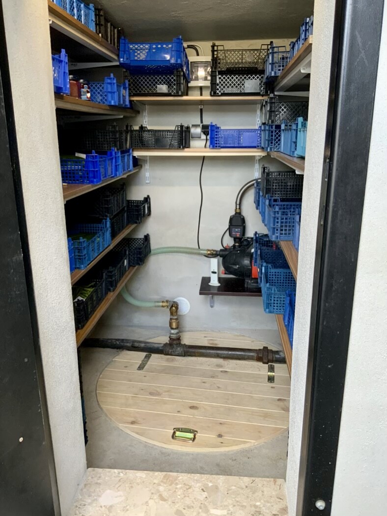

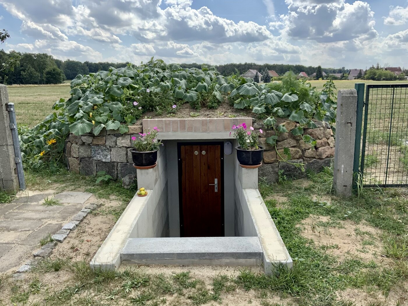

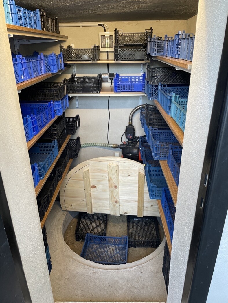

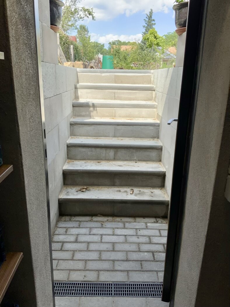

Here are a few final pictures of the completed project. The door, frame, and ground hatch were built by the neighbor. He really has a golden touch! The mound is now quite overgrown with pumpkins. The temperatures are currently stable around 19°C (66°F) near the ceiling and 17°C (63°F) near the floor. Humidity is about 90%.
