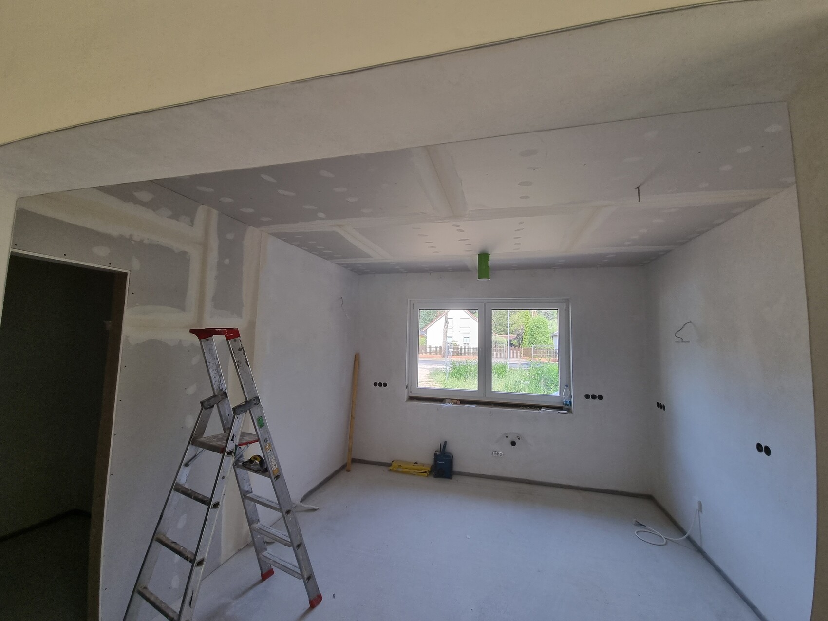

Neubau202227 Jul 2022 09:40In our house, the ducts for the mechanical ventilation with heat recovery are installed below the ceiling. This reduces the room height by about 12 cm (5 inches), but we added an extra course of blocks, so the final ceiling height is still 2.69 m (8 ft 10 in). Here are a few pictures (the green ducts coming from the ceiling).
