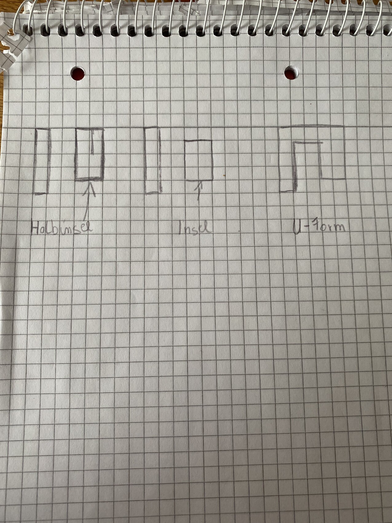

Ypsi aus NI20 May 2021 20:16pagoni2020 schrieb:
You don’t have to defend or explain yourself. The main thing is that you’re still enjoying it. It’s really starting to take shape now.Oh, it’s all fine so far! You have no idea how often people ask when we will FINALLY start building :-)
Ypsi aus NI schrieb:
Can you guess how often people ask in real life when we will FINALLY start buildingI’m checking back here again in 2022... 😀..to ask about the progress.Y
Ypsi aus NI20 May 2021 20:43haydee schrieb:
so now we’re not talking past each other anymore Is that what you mean?
Then the island creates a major one-way flow, right?
I’d like the sink and cooking area to be in a straight line, so I don’t have to drip water on the floor when moving with the wet sponge from the sink to the stove...
Unfortunately, that’s pretty straightforward ;-)
In our defense: the project was on hold for almost a year. We only recently restarted it, for the reasons already mentioned. The ‘old’ floor plan was great on the inside, but the exterior just didn’t look right. I think he means it more in general terms 😉
