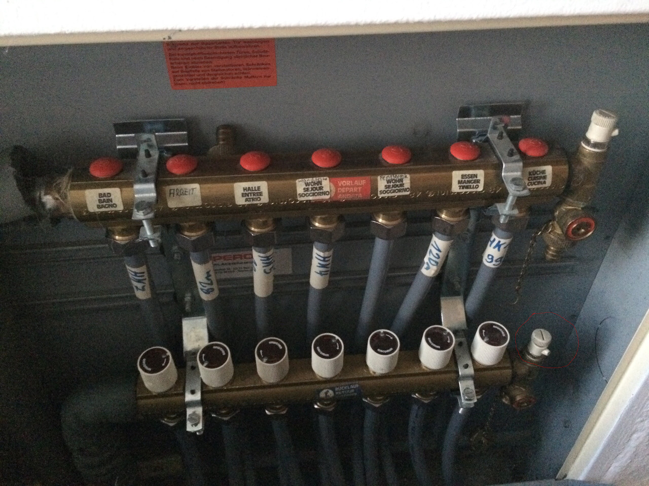

T_im_Norden2 Oct 2020 13:32Please share a photo of the heating manifold.

unheated roomsYes, I don’t let the rooms cool down completely, but there is a difference between 22°C (72°F) and 16°C (61°F).Here is a picture:
The picture actually shows nothing new; it is a typical R553D for 7 heating circuits from Giacomini. What is of interest is the consumption/heat loss of the heated building envelope. Possibly, the supply and return temperatures would also be relevant.
With high losses, it makes no sense at all to consider fine adjustments or even a thermal balancing. Here, a rough hydraulic balancing is sufficient, followed by the desired actuators instead of rotary controllers on the manifold, plus wireless thermostats in the rooms. Depending on the type of actuator, a heating actuator per manifold may also be required.
