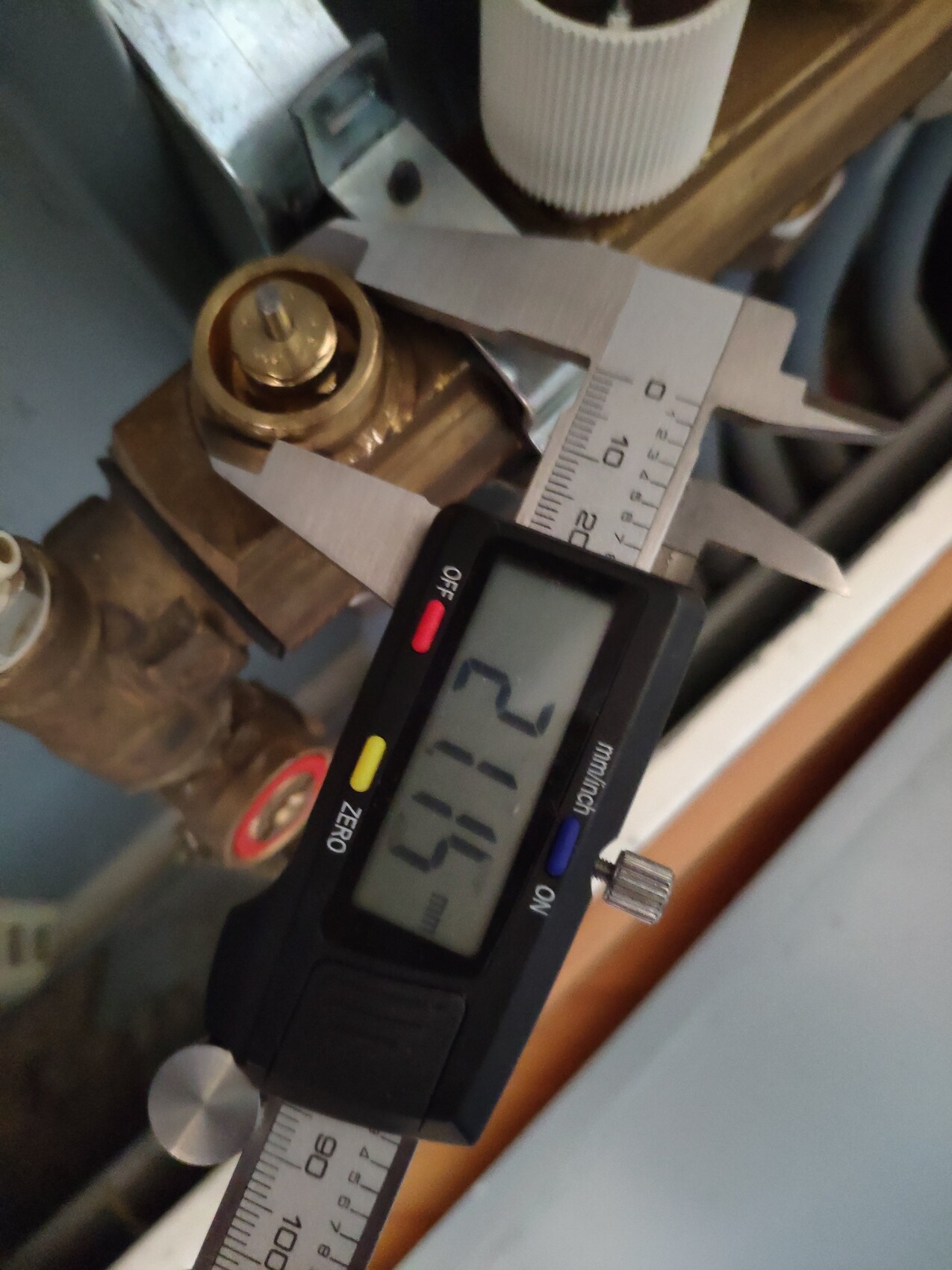

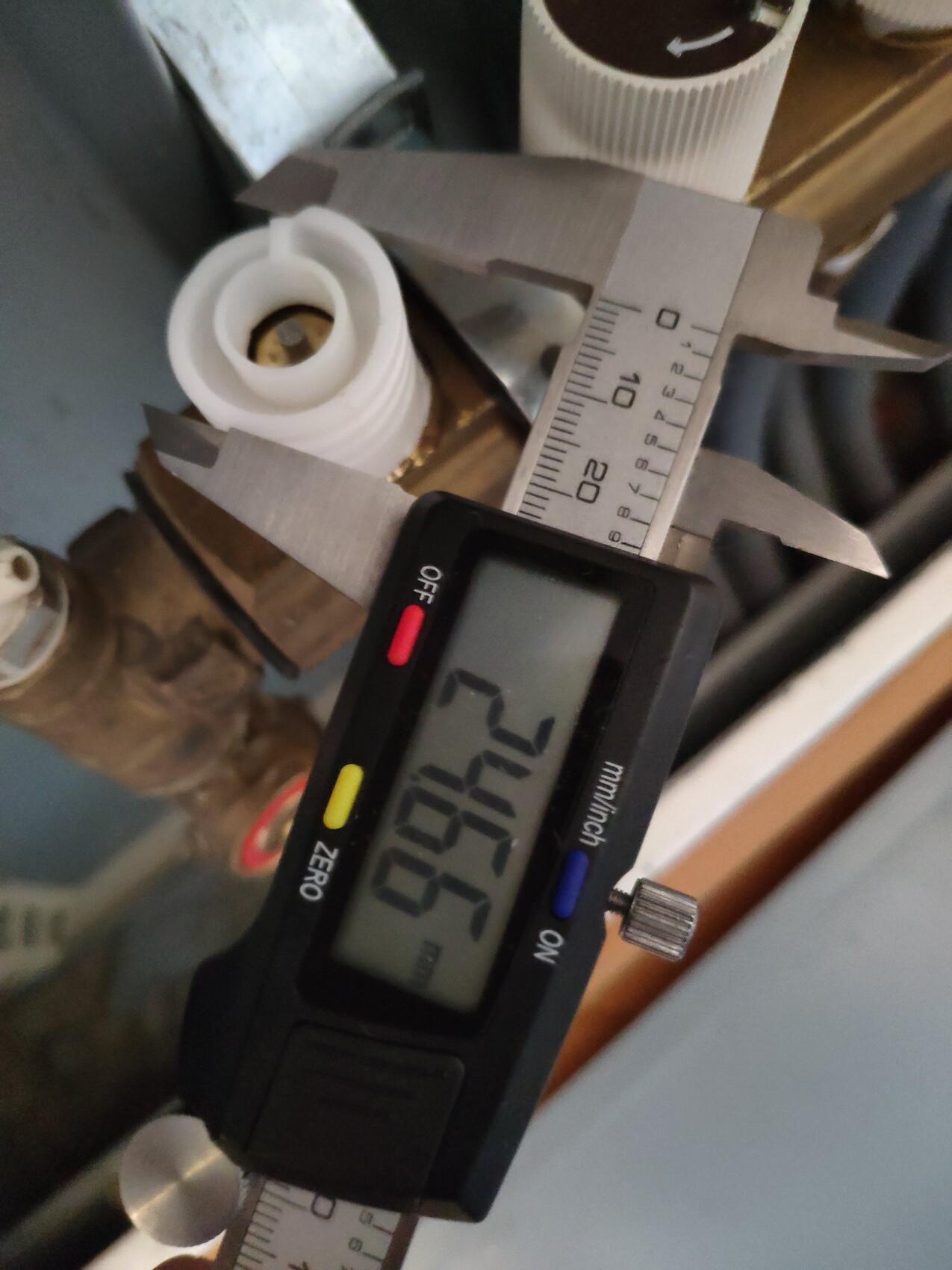

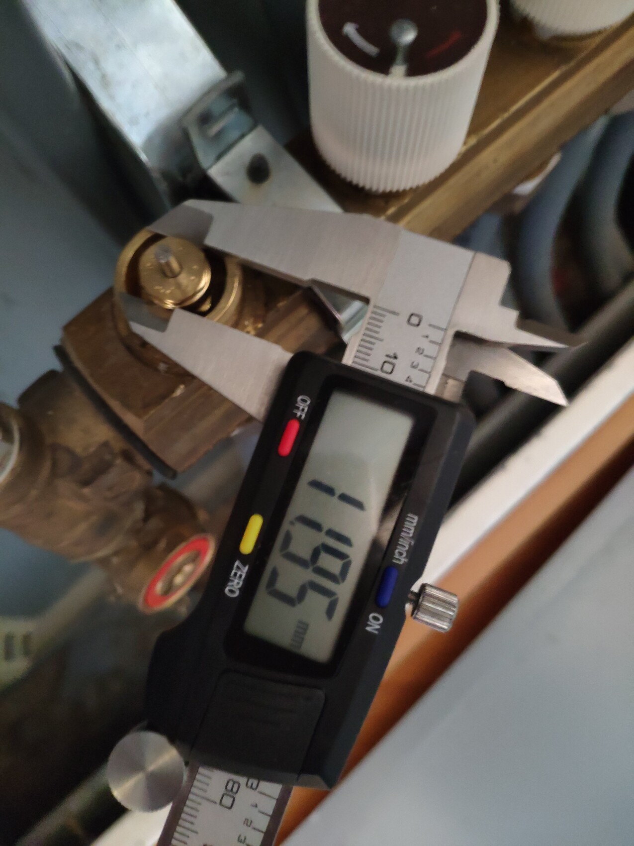

...I have now taken some measurements. The valves have plastic threads. Attached are three photos. Can you tell me which diameter is needed for new actuators (or adapters) here?

Mycraft5 Oct 2020 12:44
To avoid any further guesswork: You need the R478 or R478M actuator from Giacomini. The matching adapter ring is included.
