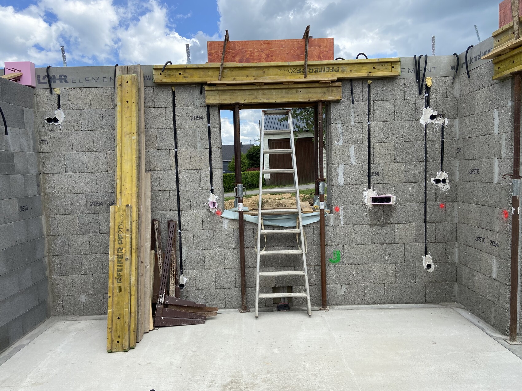

Our electrical installation is now almost complete, and the plastering is about to begin. However, I find the workmanship to be extremely untidy.
For example, I have found four different versions of the wiring for the blinds and roller shutters in the house, and some walls have more cables than space to eventually hang a picture.
Additionally, the cables are being routed over the floor. What do you think? Is this standard practice, or does it look like very poor workmanship?

Aren’t you usually the one who advises that amateurs shouldn’t touch electrical outlets? In this case, a professional company was hired to install proper and compliant electrical wiring, yet the person didn’t even use a spirit level, nor did they rely on a rough visual estimate. There are guidelines on how to route cables for a reason—after just 2-3 years, no one remembers where the cables are located, or the house changes owners. Then people want to know where the sockets are so they can safely hang pictures or mount shelves. Nobody expects the wiring in a new build to look like it was done by someone who had been at the fair the night before and didn’t get any sleep.
Today I was looking for our 6-year-old wiring inside the walls because we’re getting new interior plaster and I want to mark the cables for the plasterers. I’m glad most of it was installed properly with horizontal and vertical alignment, so I don’t have to search randomly through the walls—because after just a few years, I wouldn’t know exactly where anything is.

I also believe that the electrician is definitely capable of quickly marking a line using a spirit level. This doesn’t take more than an hour in new construction. Especially in the kitchen area, otherwise the kitchen installer will have a hard time.

You simply place the laser in the room and then chase out the wall vertically. It barely costs anything. This is just sloppy workmanship.
