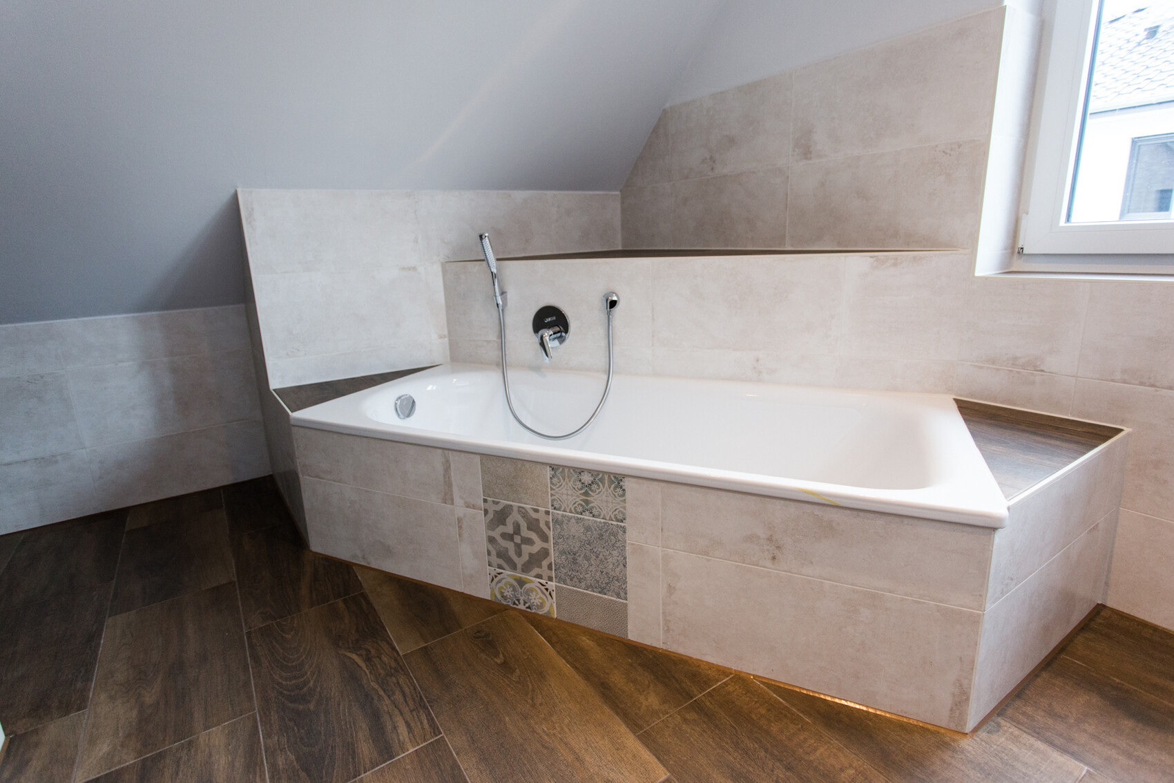

I quickly found a photo from our construction pictures. Our bathtub has many corners and edges and, accordingly, many Jolly trim rails, and in direct comparison, I think you can clearly see the difference in quality of the workmanship.
Alessandro31 Mar 2021 11:31I don’t think I’ve ever seen such a massive bathtub structure :p

I don’t think I’ve ever seen such a massive bathtub construction :pYeah, and such balanced, harmoniously coordinated corners 😎Alessandro schrieb:
I don’t think I’ve ever seen such a massive bathtub structure :p I love it! :P
But in real life, it doesn’t seem that bulky, see below. 😀
Yes, and such harmoniously balanced corners 😎 Actually, it’s symmetrical, but when you zoom out as far as possible with an ultra-wide-angle lens, it looks a bit odd in a small room. That’s due to my lack of photography skills. I’m more experienced with portraits. :P
