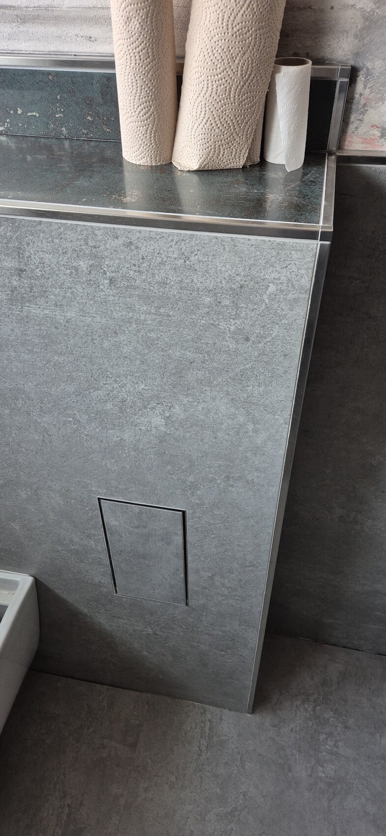

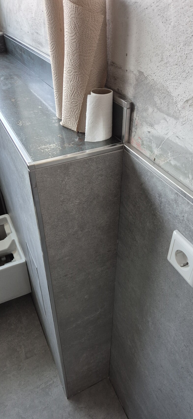

Hello experts,
maybe you can help me.
My incompetent tiler installed the tiles in our bathroom. My mother had purchased the above-mentioned Hansgrohe waste bin Xtrastoris. He was not supposed to install it yet because the electrician and plumber still needed access to the waste bin opening to run the electrical wiring and water pipes for the toilet. However, he installed it anyway because he wanted to get back at the electrician – since then, he has of course been unreachable.
Hansgrohe came by and said it was installed incorrectly. It seems he glued it firmly on the left and right sides with tile adhesive (I’m not sure about the back). The adhesive used was Sopro FKM 600.
How can we remove the waste bin without damaging the tiles? We have already tried various thin, long, sharp knives and saws, but nothing worked. It has to come out somehow.
Knut
Knut
wiltshire6 Aug 2025 17:32svcds96 schrieb:
But if the saw blade is round, I wouldn’t be able to get into the joint that well.The saw blade is semicircular. Depending on the angle you hold the tool, you can get very precisely into the joints. There are also rectangular-shaped blades available for this.We managed to remove the trash bin using a hammer and chisel, and it appears to be undamaged. However, we are missing the metal part for the lock. Where can I buy that? Is it possible to install the bin directly into the hole in the tile now, or do I need to install this black box and remove the tile beforehand?
