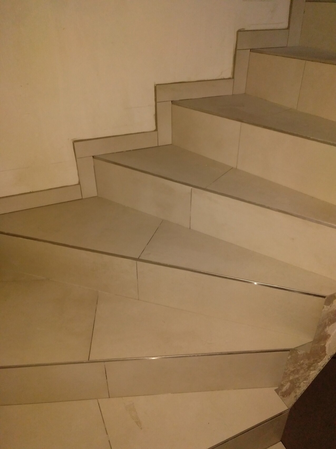

11ant15 Oct 2018 23:08
sco0ter schrieb:
Here is a photo.
I didn’t mean a macro snippet, but that you can also understand from the overall context how the staircase is "cut." Specifically, that it should have been worked out step by step how each piece fits exactly like a slice of cake.
sco0ter
15 Oct 2018 23:24
The problem is probably that the 60mm (2.4 inches) components were always installed on the inside. At least that was the tiler’s plan. Then, outside, the 40cm (16 inches) space became too tight, resulting in the triangle shape. It would probably have been better the other way around.
11ant15 Oct 2018 23:37
Redrawing it for each step yourself would have prevented it from only being superficially understood.
sco0ter
15 Oct 2018 23:46
Marking each step individually would have prevented it from being only superficially understood.
Hindsight is always 20/20... You tend to trust the professionals too much because you are just an amateur yourself.
11ant15 Oct 2018 23:56
The professional should also be aware of this trust and, in such a case, say: dear layperson, purely from a calculation standpoint (80+60 or 60+80), it will look like it avoids joints, but unfortunately not in an aesthetically pleasing way (even without the misunderstanding about the order).
From my point of view, the professional should have suggested (and I wonder, doesn’t he have a partner who would tell him this) placing the 80mm (3 inches) tiles (or the 60mm (2.5 inches) ones, but not mixed, as the batch color variation issue should have been obvious to him) in the middle of the running line. This would have resulted in one more joint, but not as a failed central stripe.

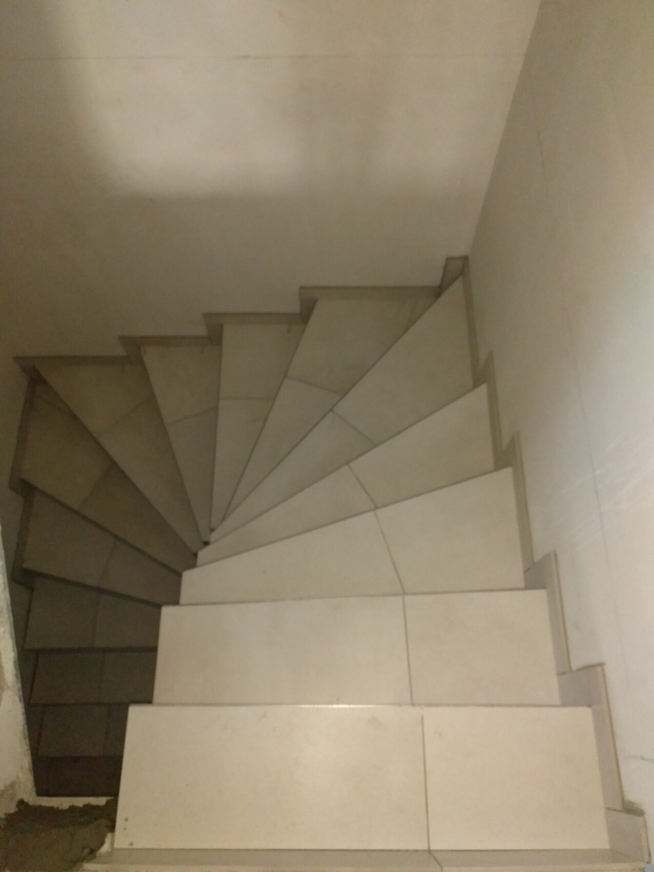

sco0ter
17 Oct 2018 23:11
Here are two more photos. I’m not really satisfied with the joint pattern. What do you think, could it have been done more harmoniously?
Spiral staircase with light steps indoors, viewed from above showing the turn.
Light indoor staircase made of stone tiles with several steps and side walls.
