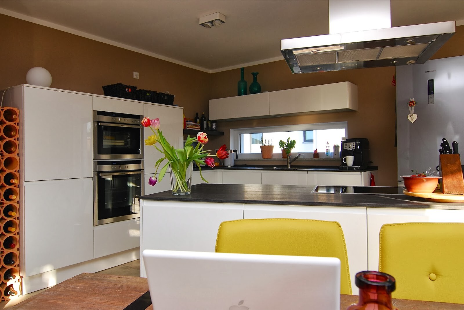

I really like it! The garden is also very nicely arranged.
Can you still reach the wall cabinets above the window in the kitchen?
I think I would need a step stool there.
...now I’ll just Google Nurda Domherren ;-)
Climbee schrieb:
Wall cabinets above the window?
I think I’d need a stool for that.No, you don’t need a stool. The window sill is low enough so I can reach the cabinets 😀 I’m not very tall... The tall cabinets are only 1.60 meters (5 feet 3 inches) high...
