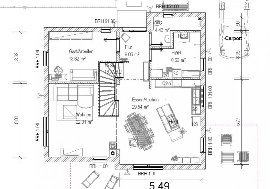

There are two of us and we plan to stay that way! We are designing a 1.5-story single-family house. The dimensions are 10.64 m x 10.94 m (35 ft x 36 ft) with a staggered gable roof. The lower roof has a 28-degree pitch, the higher one, under which the upper floor is located, has a 26-degree pitch with a 120 cm (47 inch) knee wall. The building is a typical model from the architect, but the floor plan can be freely designed. Windows are also not fixed.
Some explanations:
On the ground floor, there is a walk-in shower in the bathroom (the elongated one). The kitchen features a strip of windows. It is a large area with a big table and a counter.
What concerns me a bit is the bathroom: no shower is planned here intentionally, since we already have one on the ground floor. Still, perhaps we should consider a shower option in the bathtub?! I didn’t want a sloped bathtub, but rather a washbasin on a countertop that is somewhat longer. The line indicates the room height of 2 meters (6 ft 7 in).

In the entrance area, a small wardrobe is planned. Additionally, when guests come, all the coats and shoes should be stored in a closet (easy to access) in the study, since this room is rarely used anyway (until we can no longer manage the stairs due to age ;-))
A basement is not planned.

I’ve looked over the plans several times and, without being an architect, I’d say I would feel comfortable living in this house.
In my opinion, the layout feels spacious, and the rooms appear well-proportioned.
The only thing I would change is the basement level. I would like to reduce the size of the utility room a bit.
I’d place the toilet at the bottom of the plan (behind the door), then the washbasin at the top of the plan, and the shower to the right side of the plan.
In my view, this would have the advantage that guests wouldn’t have to walk through the whole house all the time.
17 Jan 2013 21:35
Hello Snow57, I don’t quite understand your suggestion regarding the toilet (I guess I’m a bit slow ;-).
The utility room will be reduced by 10cm (4 inches) to make the shower easier to access.

- On the upper floor, a large part of the square meters is used for a gallery that hardly anyone uses, while the bathroom is less than 10m² (108ft²), which is very small and almost like social housing standards.
- On the ground floor, I find the living room too small.
Overall, it is basically usable, but adjustments should be made.
