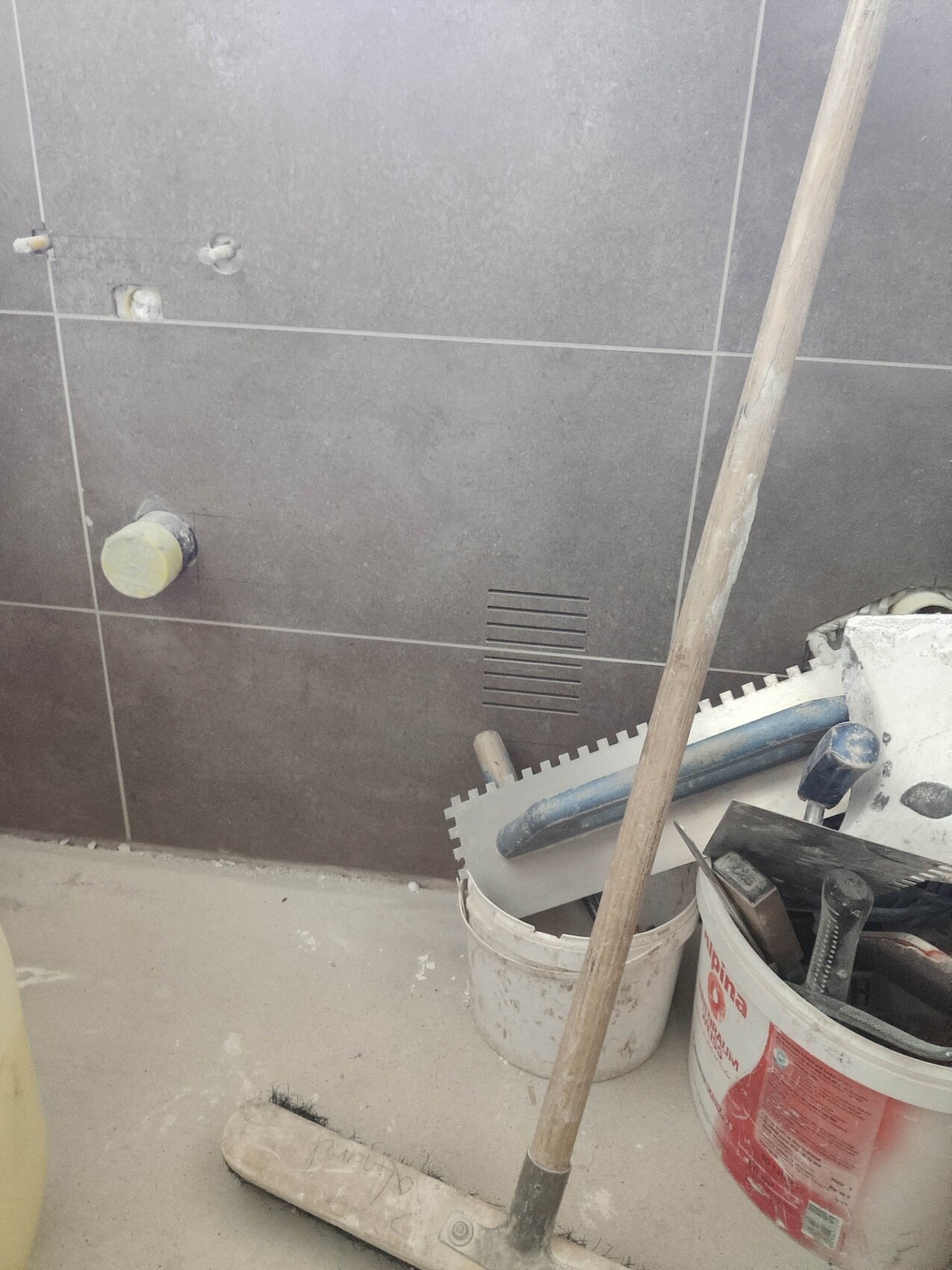

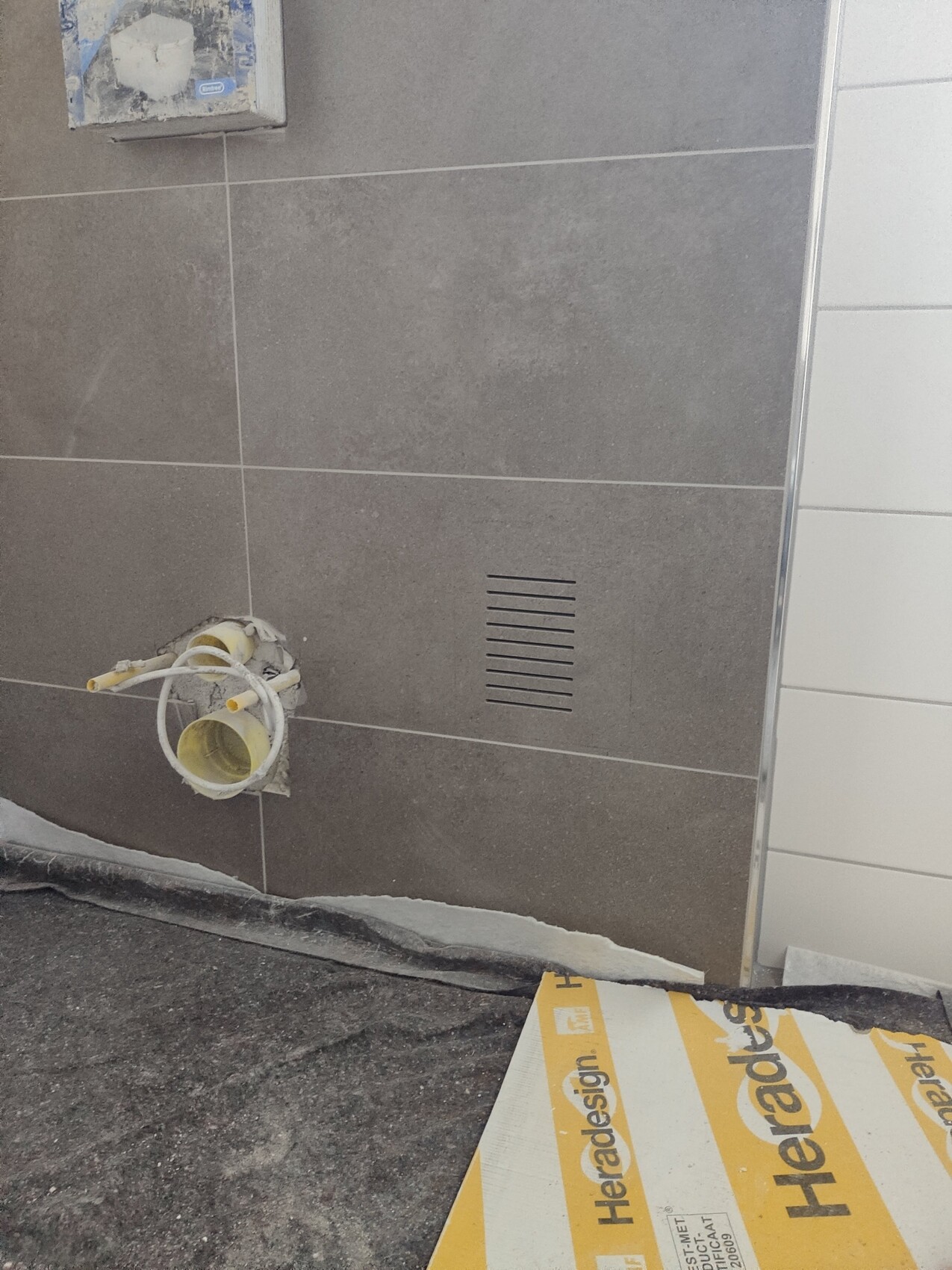

I didn’t expect this either with a new build, and it wasn’t noticeable in the plans. The architect didn’t think it was a big deal, but it bothered me. Next house will be different...
To wrap up the topic and in case other homeowners encounter a similar issue, here are two photos of the result. I could have done without it, but it’s okay like this. Definitely better than an ugly cover 😱.
Best regards!
