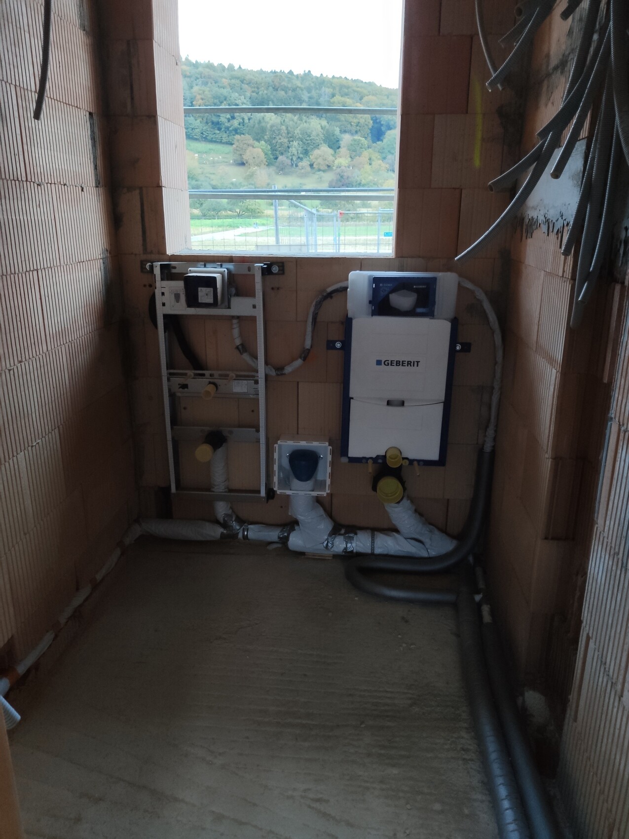

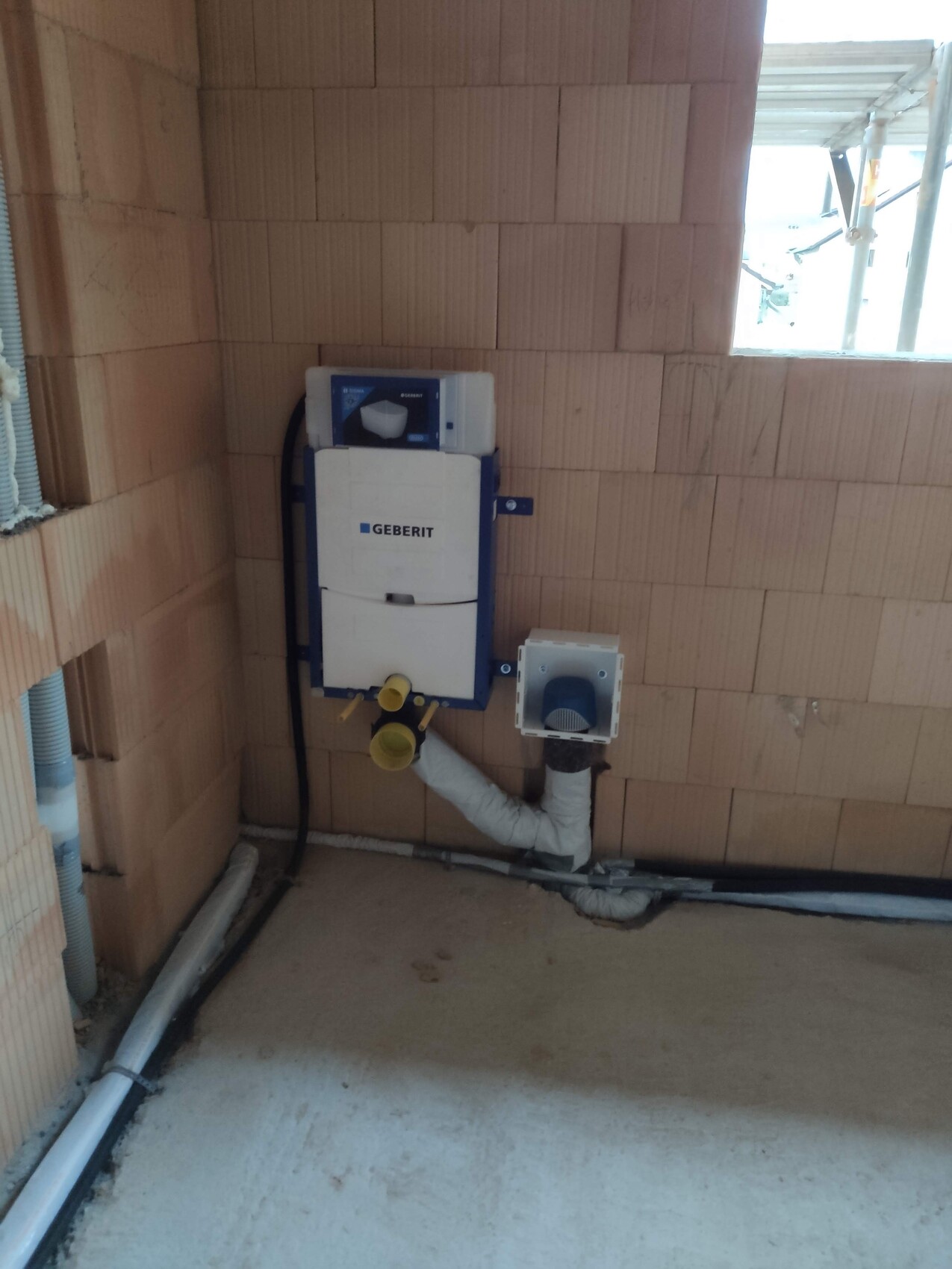

I have a question for the group because we were a bit surprised last week. We have duct ventilators in the guest toilet and the children's bathroom. Photos from the shell construction phase are attached.
During an on-site meeting last week, it was mentioned that covers would be installed over them. We simply weren’t aware of this. The vents are each located in the middle of the tiled area, and we are really concerned about how this will look afterward. An alternative mentioned was a tile with drilled holes or slots through which the ventilation would occur.
How is this handled in your homes? Do you have similar setups, and what do they look like? Photos are very welcome!
Are there maybe other options to solve this? Is it possible to simply run a conduit from the ventilator to the flush tank? That area is open behind the flush plate.
I’m also completely unsure whether a duct ventilator is a maintenance part that might need to be replaced after 5 or 10 years.

knalltüte26 Oct 2020 20:01We are routing all ventilation ducts through the roof. However, it seems that this would be quite complicated in your guest bathroom. You would need a floor-to-ceiling soffit (on the ground floor) and one on the floor above as well... Could this solution perhaps be the lesser of two evils? Maybe discuss it with the architect, although it might be too late to make changes at this point?! ops:

Thanks for your assessment! It’s reassuring to know that regular maintenance isn’t required. That already eases my concerns about having it tiled over.
@superzapp
I honestly hadn’t considered that. If it had been mentioned during the planning stage, we would have requested alternatives.
Changing it now is no longer an option. Even though it annoys me, it wouldn’t be proportional.
