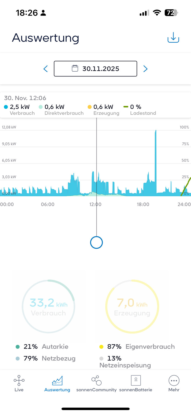

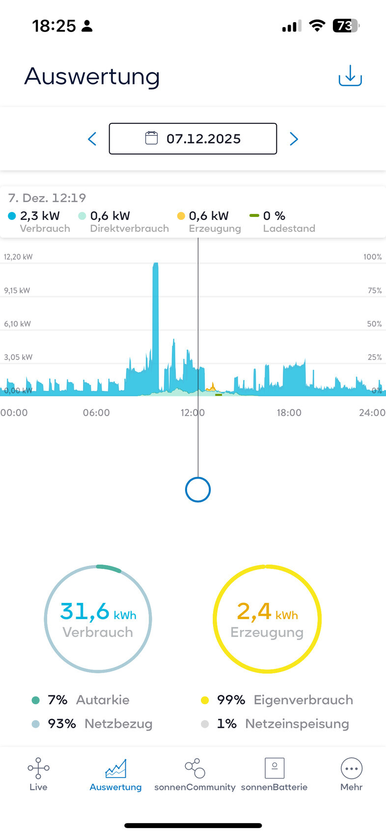

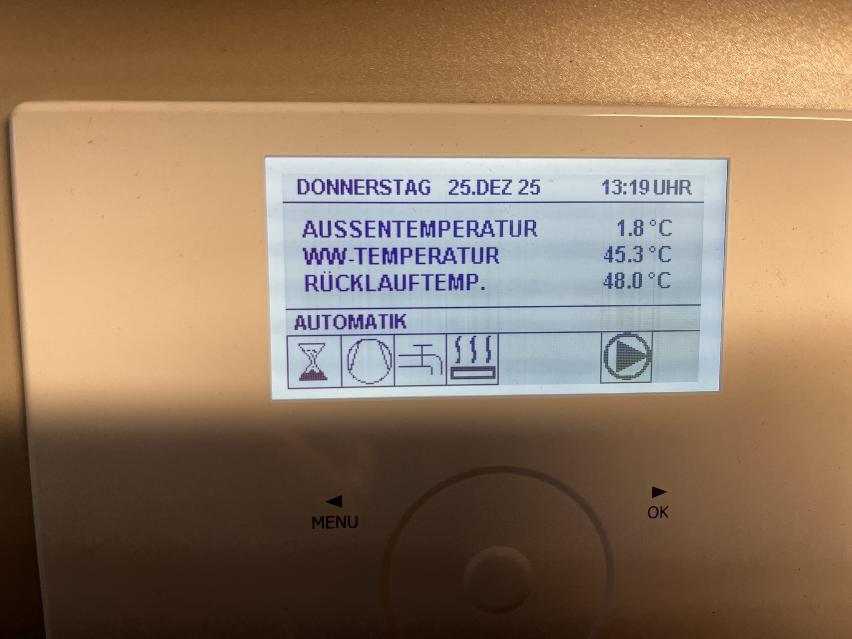

Steven300327 Dec 2025 19:34Hello everyone,
we also have a Stiebel Eltron LWZ 504 in operation. Unfortunately, we are struggling with the annual electricity consumption as well. Since we only have one electricity meter installed, I am unable to determine the actual adjusted power consumption of the heat pump.
Brief background information:
KFW 55 house
Built in 2015
175 sqm (1884 sq ft) living space
After ordering a 2-year heating system maintenance through Stiebel Eltron, which was carried out by a service company, we encountered the following problem.
The electric heating element sometimes switches on towards the end of the domestic hot water preparation. It draws 12 kW for about 30 minutes and then turns off again.
The heating technician who installed the system back then cannot perform maintenance and refers us directly to the manufacturer. Therefore, we have not yet had anyone optimize the system settings to suit our needs.
So far, I have tried to adjust the standard parameters as best as possible.
Is there anyone here who is satisfied with the LWZ504 and can help me with the settings, or explain why the electric heating element suddenly keeps switching on again?
Thank you in advance

nordanney27 Dec 2025 19:49Steven3003 schrieb:
Stiebel Eltron LWZ 504Why don’t you turn off the heating element completely? What is the domestic hot water target temperature? Maybe the heat pump can’t reach the set 65°C (149°F) – just a random figure.
Those would be my first and most important questions. You can always dive deeper later.
Steven300327 Dec 2025 20:13S
