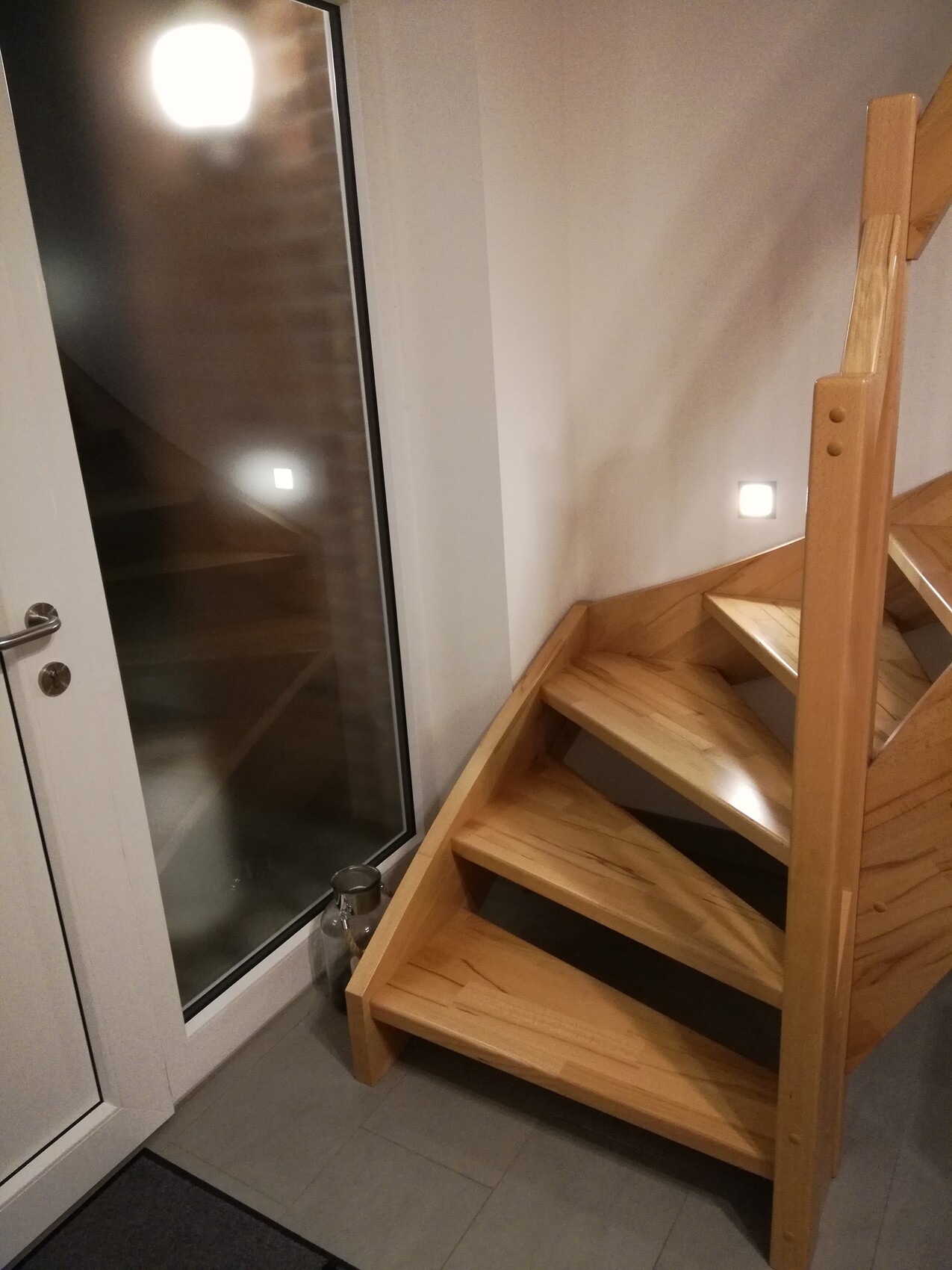

Our youngest child (1 year old) has developed a strong interest in the stairs. We need a suitable safety gate. Despite extensive searching, I haven’t found an appropriate stair gate yet. Even specialty stores only recommend the usual models.
The problem is that we don’t have a wall on one side. Attaching the gate to the glass is probably not an option. Naturally, we want to avoid causing as much damage as possible, so clamping would be preferred.
The only idea so far was to attach a second horizontal bar to the bottom step on the door side and then secure a gate between them. It’s unclear how stable this would be.
What could be a practical solution here?

hampshire25 Nov 2020 21:18Clamping mechanism for securing the gate to the post and locking the gate at the bottom step. Operated via a pull element to avoid bending down and to allow opening the gate from the top side as well. Requires some tinkering, holds up over time, and does not cause long-term damage.
There are also stair gates that can be adjusted so that they can be screwed to the wall next to the glass element, and then the stair newel post is used for the second attachment point. I know at least one manufacturer who offers something suitable for this purpose—can I mention them? Otherwise, try searching for the manufacturer whose name sounds like Euther from the cow but with a G in front. They have a stair gate that should actually be usable for this.
At that time, we used a stair gate in the form of a retractable barrier. It was installed starting from the third step, as there was no alternative. The advantage is that the gate is not constantly in the way. The disadvantage: it cannot be opened with one hand.
The retractable barrier was screwed to the wall, and the matching part was clamped to the staircase.
