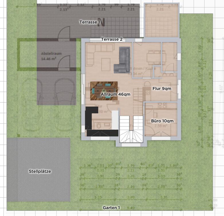

I am now hoping for some suggestions on how we could get more out of the current floor plan while keeping the same room layout. I assume the simplest way would be a different staircase design.

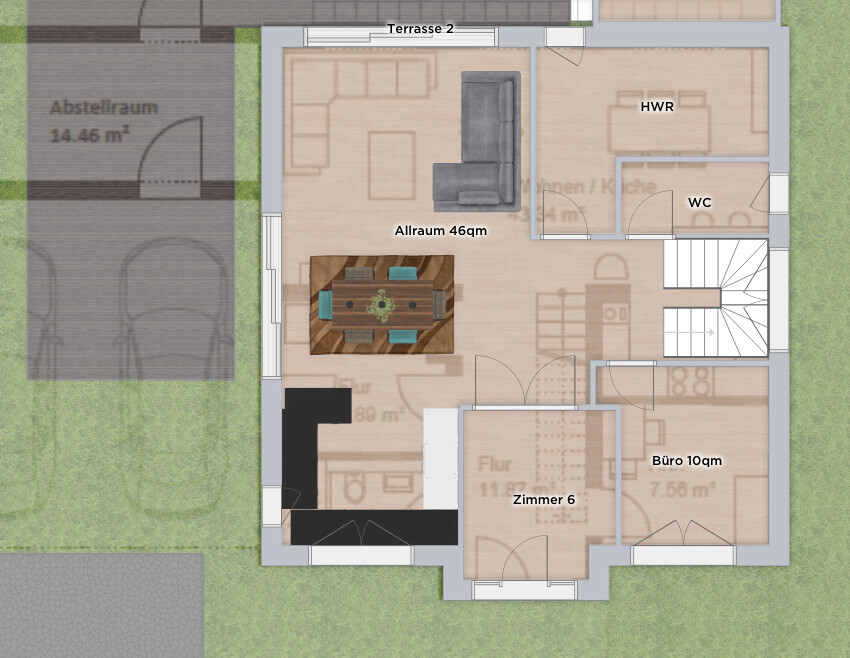

Floor plan of a house with terraces; open space 46sqm (495 sq ft); hallway 9sqm (97 sq ft); office 10sqm (108 sq ft); garden; parking spaces
Ground floor plan: open living and dining area with kitchen, office, room, hallway, WC, utility room, terrace.
kaho67415 Apr 2020 13:40
since I don’t know how the entrance on the east side will be received.
I would also wait to see how the decision to move the layout of the open-plan living area away from the garden side will be received. That wasn’t planned before.
