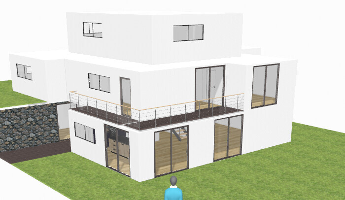

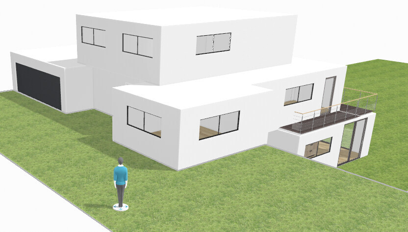

My husband is watching sports, so I’m quickly sharing a SKETCH before dinner – or rather some 3D views... if this were my house, and I had all the requirements like the original poster.
On the ground floor... about 15 x 16 meters (49 x 52 feet), with variable front and rear offsets, since the staircase is almost centrally located. The windows are just examples in the larger rooms and measure 2.40 meters (7 feet 10 inches) wide.
The interior layout also works well:
- Double garage with space for bikes, check; utility room, check
- 2 kids’ bedrooms, guest/au pair area, home office, library, check
- In the basement: multi-purpose room, fitness area, utility room, freezer room, wine cellar, and so on
- On the upper floor: master area with workspace
Check, check, check
- I forgot the piano, but there would definitely be space for it somewhere, since many parts are flexible – at least without professional architect knowledge 😀
If I defined the exterior walls with the correct thickness, it would result in around 360 square meters (3,875 square feet). With my rough 10cm (4 inches) wall thickness, it comes to about 380 square meters (4,090 square feet) including the garage.
