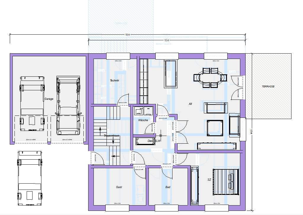

I was advised to post my floor plan here, as there are always good suggestions in this forum.
We have a plot of just under 775 sqm (8340 sq ft) and need at least 3 parking spaces in total – 1.5 per residential unit. Since street parking is not possible in front of the plot, a garage or parking space on the property is very important.
The building envelope measures 12×18 m (39×59 feet).
We are planning a ground floor with one upper floor and a partial basement, with a single-sloped roof.
The current driveway faces north, and the terraces and living room are oriented to the south.
Currently, two adults in their early 30s with one child, more children planned, plus two people in their mid-50s living in the granny flat.
The granny flat should be entirely on the ground floor for age-appropriate living and must have room in the bedroom for a large wardrobe and another room for guests or an office.
The basement will be used for storage and technical equipment including the heating system.

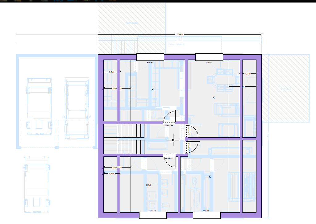

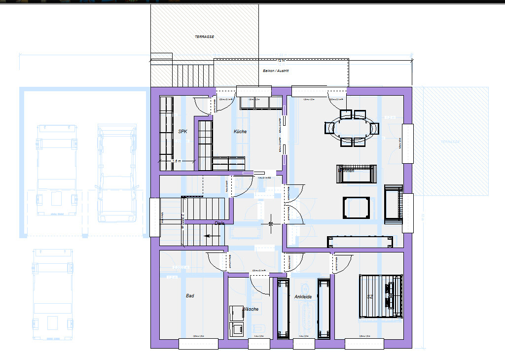

The current design comes from the architect.
I’m unsure about the layout of the ground floor – possibly too much hallway and the living/dining area might be too small. On the upper floor, I wonder if the size of the children’s rooms is appropriate compared to the master bedroom and walk-in closet.
