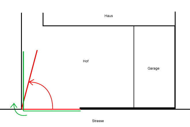

I’ve gathered all my basic drawing skills and sketched out a rough plan—not to scale. The red represents a "swing gate," which is less suitable due to the slight slope in the courtyard, and the green represents the side sectional gate if such a thing exists.

The garage in the drawing appears to be accessed from the street rather than through the yard (?) – but you also want to be able to drive through the yard (?)
The slope does not prevent a conventional yard gate; this can be taken into account when installing the hinges. For pedestrian access, I would design the gate as double-leafed, with a wing about 1 meter (3 feet) wide on the side facing the garage. By the way, swing gates are something different: these were common for garages before sectional doors became popular.

Sorry, the garage door is on the long side, and there is only a wall facing the street. This is a garage with space for 2.5 vehicles side by side. So, I have to drive into the courtyard. As I said, none of this is to scale 🙂
The slope causes the swing gates to tilt upward when open. A neighbor has this, and it really looks awkward when open.
I’m starting to get used to the sliding gate along the wall…

I currently have one of these, and there is really nothing to get used to. I find it better both visually and practically than these swing gates.
I didn't understand the pedestrian mode. You wouldn't want to open the gate just by ringing the bell, right? Most can be programmed for a partial opening, but I would rather provide a regular entrance gate at the corner for that.
