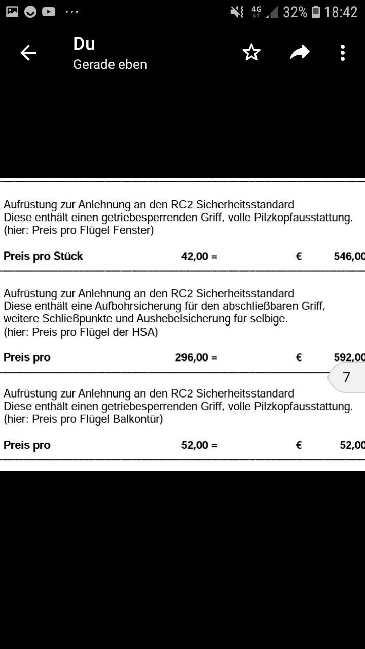

The topic of burglary security comes up here from time to time. Our house will be fitted with about 8-10 tilt-and-turn windows accessible at ground level, and we are wondering how to make it more difficult for burglars. Our window supplier offers fittings rated RC2 or similar to RC2, priced at around 275 euros per tilt-and-turn sash plus lockable window handles for about 50 euros each.
As far as I understand the security classes, this would be RC2N since the glass itself does not yet meet the higher requirements. For that, the outer pane would need to be P4A, right? Would this then even be laminated into the frame? If you use RC2 fittings, is it strongly recommended to also use P4A glass?
In addition, we have two lift-and-slide units that we could also upgrade with RC2 fittings. However, I wonder how burglars would be able to pry open a lift-and-slide door sash weighing several hundred kilograms?
There is also the option to install electronic window contacts: ROTO MVS VdS C at approximately 175 euros each and locking contact sensors VdS C for multipoint locking at about 160 euros each.
That adds up quite a bit. Regarding the electronic contacts, I still don’t fully understand what would be sensible. Has anyone here dealt with this topic and could provide advice?
