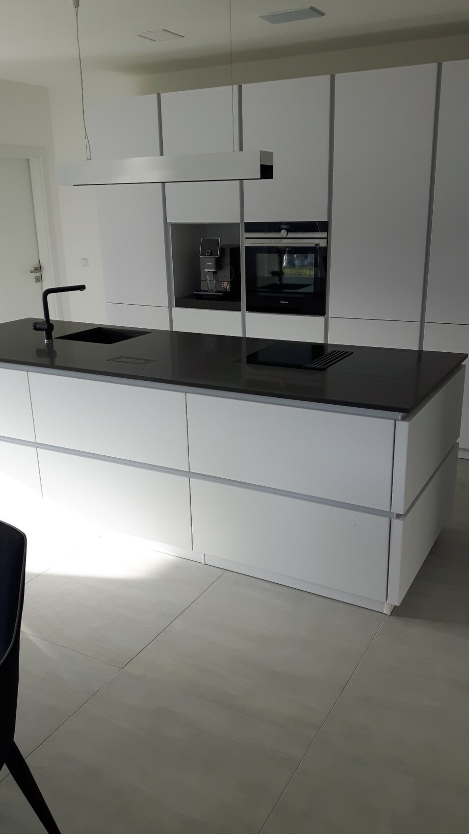

Fuchsbau3528 Apr 2022 10:40A well-known Swedish furniture store offers a recessed cooktop for 1600 €.
We also have an island and chose a Miele induction cooktop with an integrated downdraft extractor.
We had the builder install a large exhaust duct directly into the floor slab and routed it out on the north side.
It works perfectly. Almost "all" odors are captured and vented outside.
I would definitely do it again. We initially considered a ceiling-mounted range hood and even had a ceiling reinforcement planned, but for aesthetic reasons, we ultimately decided on the downdraft extractor.
