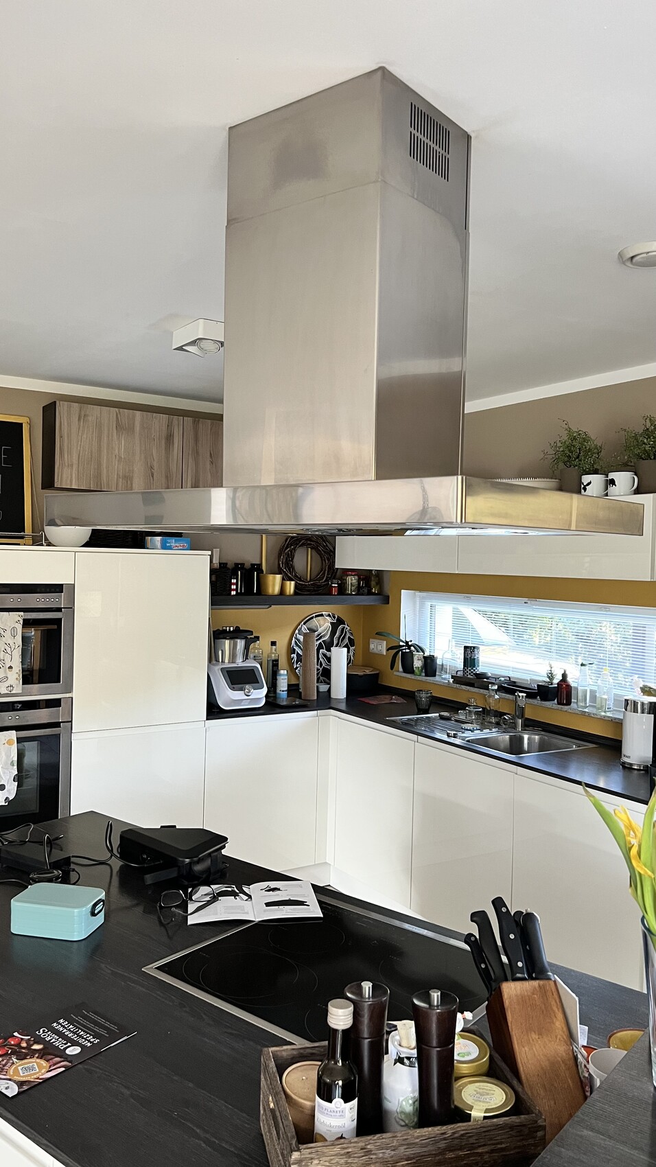

We have something like that from Franke... and for higher ceilings, there are also “adapters,” including stainless steel ones.
27 Apr 2022 18:44
We have something like that from Franke... and for higher ceilings, there are “adapters,” also available in stainless steel.
Back then, it was 400€ (we were careful with money too 😉 )
Modern kitchen with central stainless steel range hood above the cooking island and white cabinets.
