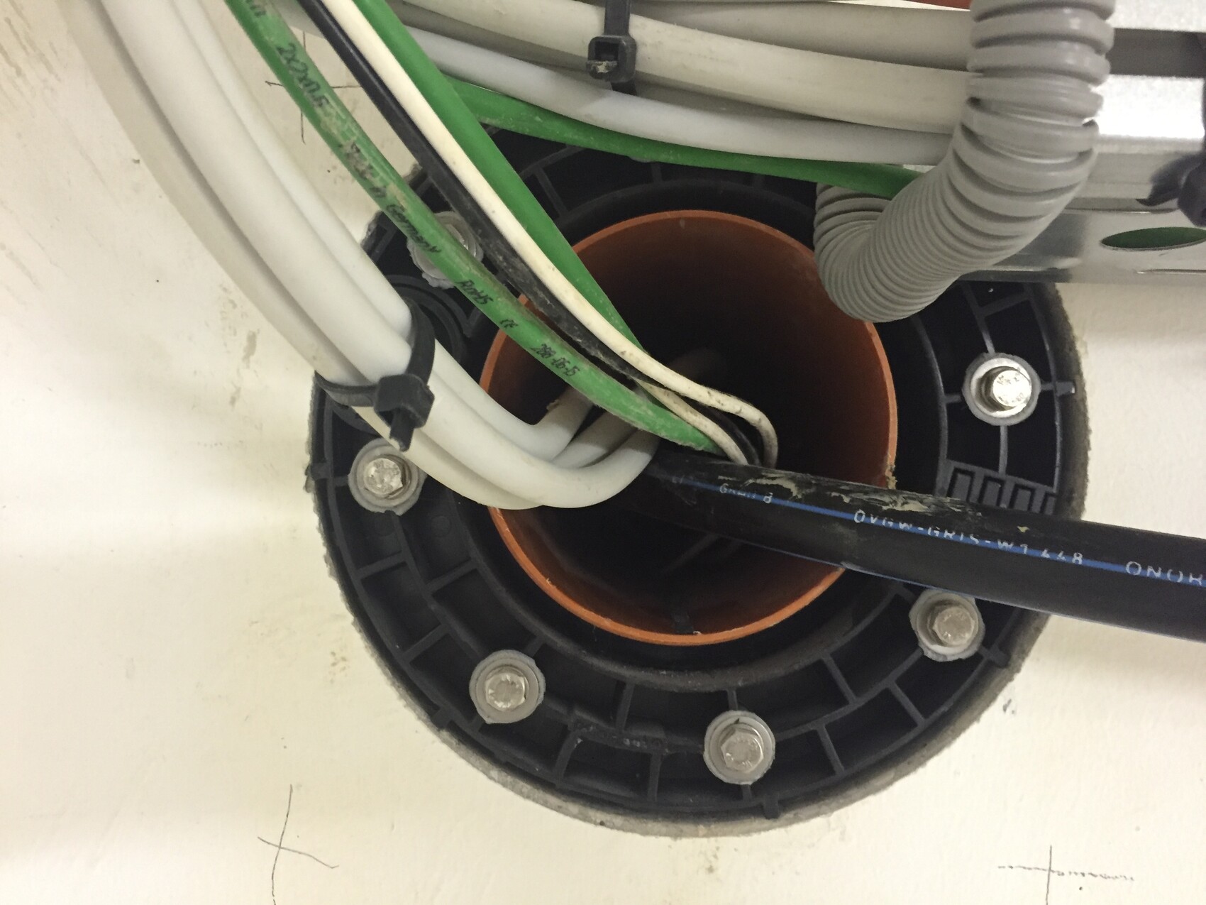

I have a pipe running from the basement to the pool equipment room to create a water connection leading outside. This means I now have a pass-through from the basement to the outside. The necessary cables are already installed, but how can I properly seal everything now? I have attached a picture for reference.
Can anyone give me a good tip?
Thanks in advance.

Are both rooms part of the building, or is the pool room located elsewhere on the property?
F
Fleming
30 Oct 2016 19:35
This is just a small technical shaft by the pool where the pump and filter are located. So, it is not inside the house but outside.
Knallkörper
1 Nov 2016 11:58
With a split annular space seal. Since the cables are already in place, it must be a split annular space seal.
