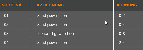

Thanks also for the tip about the drainage. We actually installed drainage pipes because the ground is extremely clayey and rocky. Naturally, they shouldn’t get clogged. I wasn’t referring to the drainage pipes. Sand simply has a water-draining effect (called drainage). This improves the more it avoids clumping and the more space there is between the grains.
tomtom79 schrieb:
Sorry, but I don’t know any sand with a grain size of 4mm (0.16 inches); that would be more like fine gravel. My local gravel plant still classifies that as sand.
