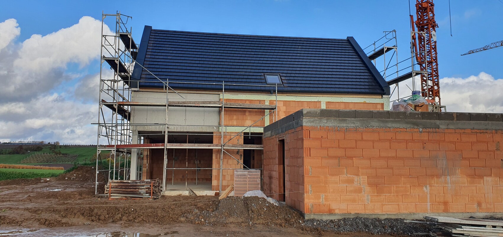

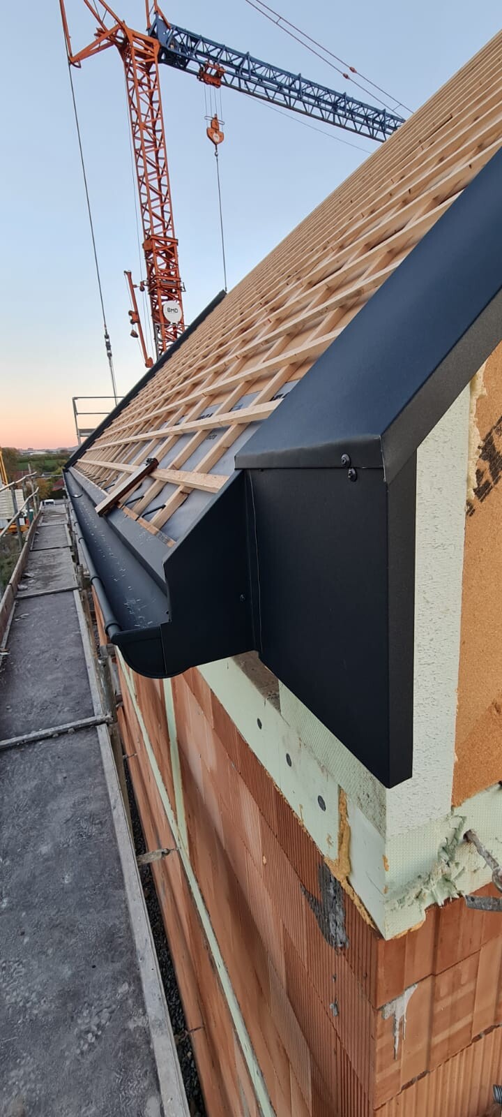

We are building without eaves overhangs. The gable side has an aluminum parapet, and the eaves side has a very small overhang with an external gutter. Initially, we wanted an internal gutter, but for technical reasons, we changed our minds.
The facade will be painted with a silicone resin paint featuring a lotus effect.
Some builders advised me to include an eaves overhang. Parapets on the gable end are very rare or almost never built in this region.

We are also considering this roof style; can you tell me if it differs in cost compared to a standard roof overhang?I can’t tell you, as I didn’t inquire about the cost of a traditional roof. You have to build the parapet (+ cover it with metal flashing), which costs more, but your roof will be somewhat shorter. You save a few square meters of roof tiles...Similar topics
