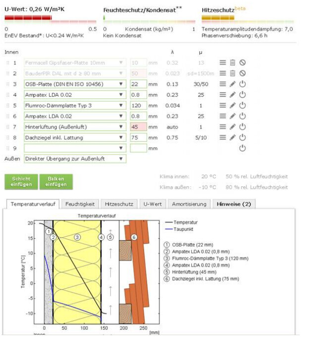

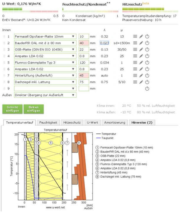

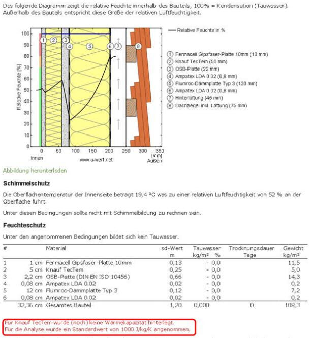

sOKRATEs10025 Jan 2015 17:18Hello everyone,
I have now received the information I was still missing. I have attached a picture here.
For the moment, I am considering two options.
Option 1: Bauder PIR 40mm (1.6 inches) with drywall on top.
Option 2: Knauf TecTem 50mm (2 inches) with drywall on top.
Both options look good in terms of moisture. So, it seems I could even use drywall panels that have a 4cm (1.6 inches) EPS layer glued on them, right? According to the U-value calculator, this would give me a U-value of 0.186 with zero condensation. This should probably be the most cost-effective solution, correct?
Thanks for your answers so far.
@schwarz.b: Nailing through the rafters is not an option since I want to keep them visible.
I would appreciate any further opinions from you.
Dennis
