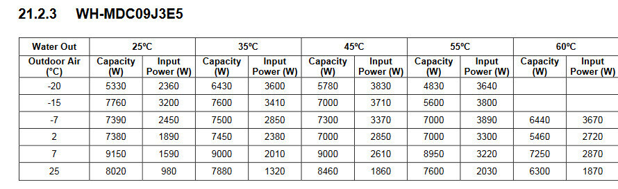

WilderSueden23 Jul 2022 12:20Deliverer schrieb:
So: Up to a 55° supply water temperature, using a modern heat pump is NOT a cost trap. The heat pump only loses about 13% efficiency compared to a 35° supply water temperature (study from last year).I actually have data sheets in mind that show a bit more than 13%, even at rather mild temperatures. This combined with a high heating demand...CC35BS38 schrieb:
Try testing in winter how low the supply temperature can go. Turn the radiators fully on. You should aim for around 40°C (104°F). At 50°C (122°F) and above, it becomes quite expensive and inefficient. With a "fever temperature," you definitely cannot heat a 1960s house (without insulation measures) with radiators.
Deliverer schrieb:
So: Up to 55°C (131°F) supply temperature, using modern heat pumps is NOT a cost trap. The heat pump only loses about 13% efficiency compared to a 35°C (95°F) supply temperature (study from last year). That’s the theory, or rather in the lab. Seasonal performance factor instead of 5 just barely over 4? 🙄
50°C (122°F) would be like producing hot water all year round.
The annual performance factor would probably hover around 3 then.
(I’ve already seen that with our ground source heat pump, even though it’s from 2009, that anything above 45°C (113°F) significantly reduces efficiency.)
It would be nice if it were different, but I don’t believe in quantum leaps in heat pump technology.

Deliverer23 Jul 2022 13:06You’ll need to find the study from ifeu yourself—I’m unfortunately not allowed to share links.
(And I have to correct myself: it was 14% more electricity between 35 and 55°C (95 and 131°F).)
Please don’t misunderstand me (or the study): I’m not recommending 55°C (131°F). But keeping this information in mind, you don’t have to worry so much if you occasionally need a flow temperature of 45°C (113°F). And with 45°C (113°F), you can already heat a lot of houses!
