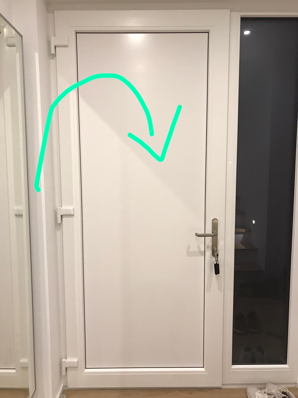

We moved into our house in April, and you have always supported us. Now I need to take action again and would appreciate your feedback. :-) We have a stylish front door, but we occasionally hear cars passing by from the street. The house is located about 30 meters (98 feet) from the road, which is a village street. No cars pass by in the evening, but there are some during the day. Is there a way to add sound insulation to the inside of the front door afterwards? It is completely airtight. The noise penetrates through the door leaf.
Here are some ideas I have considered:
Attached is a photo. The window next to it is triple-glazed (SSK 4). Nothing gets through there except when a truck drives past on occasion. What do you think? Many thanks in advance. I love this forum. :-)
- Double boarding with Knauf Silentboard, then plastering. Attach using Beko construction adhesive without drilling.
- Bond 10 mm (0.4 inch) laminated safety glass with PVB film in glossy white.
- Carpenter option with mineral wool and a new inner frame applied on top. We know him well, and he’s enthusiastic about trying this experiment.
- Contact door manufacturer for a new inner panel… this is probably the most extensive option.
Bauherr&-frau schrieb:
What do you think?Honestly? The effort involved in adding extra measures to an existing door (which might not even be feasible), with only occasional traffic during the day on a street 30m (100 feet) away: effort versus benefit? I’d rather save that money and, in the post-Covid era, have a nice meal out with the builder. That would make me happier. As Confucius said: There is always some noise.
This is a diplomatic response that also brought a smile to my wife’s eyes! Thank you. :-) Now, purely theoretically speaking: would the option with the Knauf boards work?
I can't really contribute much from a technical standpoint. However, with our doors and windows, it turns out that most of the sound passes through the junctions and edges. From my perspective, adding a panel to the door leaf would not achieve the desired result. Aside from whether it can actually look "nice" aesthetically.
knalltüte19 Jan 2021 08:49You actually need something soft or damping, yet heavy (bitumen sheets, for example). These would prevent the thin filling from "resonating." So something from speaker construction ;-) but more aesthetically pleasing. I wonder if mineral wool plus panels would be enough? Even though mineral wool is supposed to help acoustically separate rooms in timber frame construction... I’d take the risk ;-)
Visually, you don’t have much to lose :p
Is the panel covering the outer edge of the frame, or is that why you are considering adding an additional layer rather than replacing the panel?
