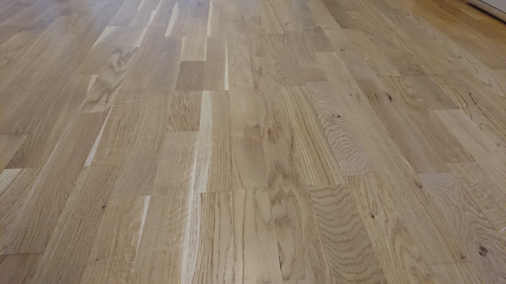

Please excuse the long silence. I just wanted to briefly share the outcome here:
You were right about the engineered wood flooring, and it was definitely worth refinishing the floor. Mainly due to time constraints (the moving date was approaching rapidly, and there was simply too much to do), I ultimately hired a company. The floor was sanded down and treated with parquet varnish. I am very satisfied with the result. However, taking good photos of this kind of flooring is quite difficult. At least you can see a bit of the difference, I think.
