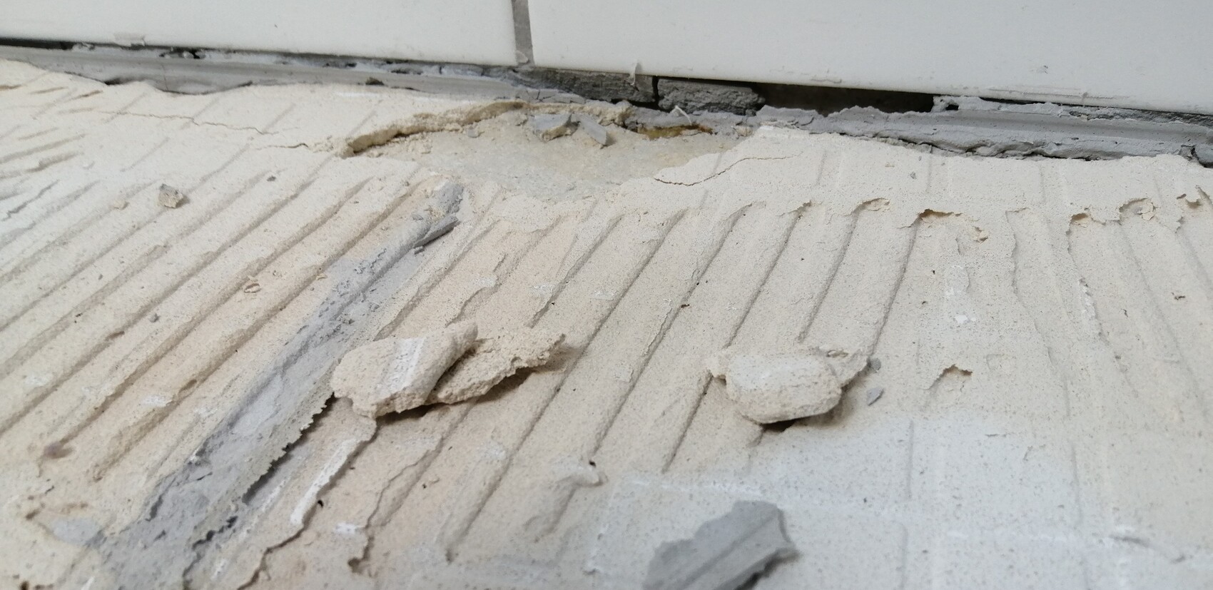

I want to have a bathroom floor covered with click vinyl or tiles.
I have already removed the tiles.
Now I want a professional company to remove the adhesive. See photo.
1) Do I need to make sure that the adhesive residues from the floor tiles are also removed under the wall tiles, or is it common to remove the adhesive only up to the edge of the wall tiles? Since the area will be finished with silicone, the joint won’t be visible.
2) What is the approximate cost for this work? The area is 4 sqm (43 sq ft).
Thank you
Broken plaster pieces on a ribbed screed floor in front of a door edge.

Gerd53 schrieb:
2) How much does the job roughly cost? It's 4 sqm (43 sq ft).
That will be difficult. For such an unprofitable job, you will probably have to accept whoever is willing at all. It can quickly amount to several hundred €.
Gerd53 schrieb:
1) Should I make sure that the adhesive residues from the floor tiles are removed under the wall tiles, or do you only lay the tile adhesive up to where the wall tiles start? Since the joint is finished with silicone, the spot won’t be visible anyway.
Either you lay the floor tiles up to the edge and then install the wall tiles on top (standard procedure), or the other way around. In the end, only the silicone joint is visible.
Since in your case the floor tiles will hardly be slid under the wall tiles again, the adhesive residues can remain.

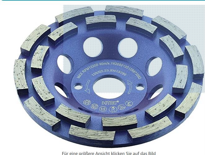

I would also try using a hammer and chisel. It’s something you can definitely do yourself. And for the leftover parts that don’t come off completely, you can probably work on them with a concrete grinder, right? Something like the one in the attachment doesn’t cost a fortune, you just need the right angle grinder.
Blue, round grinding or polishing disc with segmented outer edges and a center hole.
