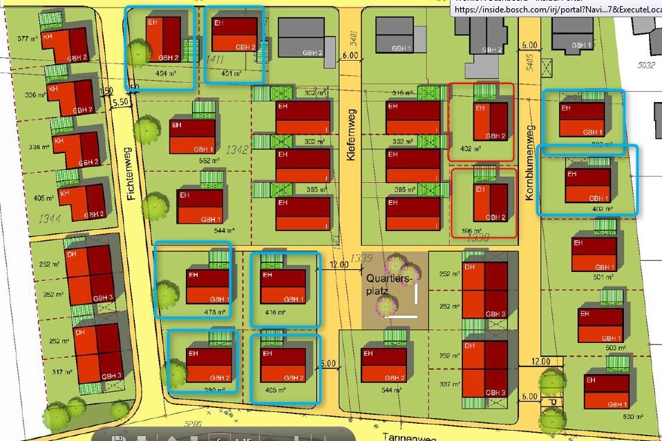

Next year, a new development will begin in our area, and we originally planned to apply for one of the plots.
Now, during the early public participation phase, a development plan has been published, and we are unsure whether our desired house can actually be built on any of the plots.
Based on the land prices of 350€/m² (approximately 33 USD/sq ft) and a total budget of 500,000 euros excluding additional costs, I circled the eligible plots in blue purely based on price. We would prefer not to build a townhouse or semi-detached house.

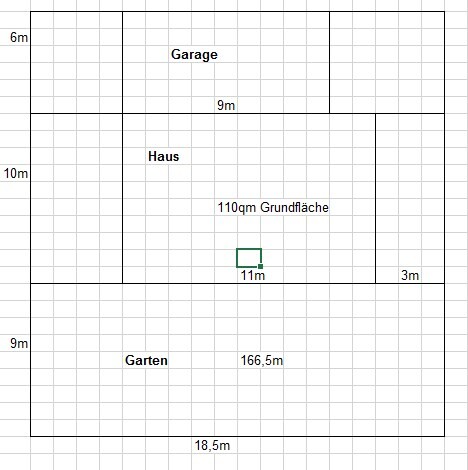

A strong wish of my partner is to have a large double garage (6m x 9m) (20ft x 30ft), as he is hobbyist who works on cars and currently rents a garage in another town to pursue this hobby.

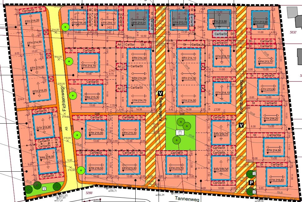

If I interpret the development plan correctly, a double garage is only allowed on the two plots outlined in red because most plots along the street are rather narrow and elongated—whereas these two plots are wider, allowing for a building zone of 13m (43ft) on the side facing the street and deducting 3m (10ft) for the garage.
Subtracting the 3m (10ft) for the garage leaves a building zone of 11m x 10m (36ft x 33ft) for the house, which results in a footprint of 110m² (1,184 sq ft) (I also sketched this out in Excel and attached it).

Regarding the garage, the zoning plan only states the following:
a) Garages as enclosed garages within the meaning of § 1 (2) GaVO, covered or open parking spaces (open garages within the meaning of § 1 (1) GaVO) are only permitted within the buildable areas of the plot (building boundaries) and each only on the areas designated for this purpose in the site plan.
The permissible site coverage ratio (floor area ratio) may, according to § 19 (4) of the Federal Land Utilization Ordinance, be exceeded by up to 50% through the site coverage of garages, carports, parking spaces with their access routes, ancillary structures within the meaning of § 14 of the Federal Land Utilization Ordinance, and by structures below ground level. For "Deviating Building Method 2" (A2), the maximum allowable site coverage ratio may be 0.80 (§ 19 (4) 3 of the Federal Land Utilization Ordinance).
I interpret “only within the buildable areas of the plot (building boundaries)” to mean that it is possible to use part of the building envelope set for the house for the garage. But “...each only on the areas designated for this purpose in the site plan” suggests that a garage is only permitted on the part of the lot marked specifically for the garage, which would be a deal-breaker for us.

The areas shown on the plan are usually just examples of how construction can be done. Since garages are buildings, they may only be built within the building zone (if defined). How many meters may be placed along the property boundary is regulated by the regional building code.
Regarding the roofs: in Lower Saxony, roof overhangs under 50cm (20 inches) do not count towards the buildable area, everything beyond that does. I don't know how it is in Baden-Württemberg.

... and this “and” defines the location. That’s how I read it.

“allowed only on the areas designated for this purpose on the site plan” I interpret this to mean that a garage is only possible on the part marked for the garage, which would already be a deal-breaker for us.
